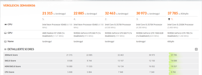

kithylin wrote:
I guess it's time to comment I did come up with the fastest XP video card. At first I figured it was the nvidia 700 series. Then I found out that EVGA hand-binned all of the GTX 780 classified cards to at least 80% or higher ASIC Quality and they all overclock to the moon with a tuned bios. And I picked up one off ebay for $180 and got it here and tuned it's bios myself and have it clocked at 1268 core and 1900 mhz (7600 effective) memory and mated it with my Z77 gigabyte board and a i5-2500K @ 5.1 ghz and it's now my system that dual boots XP and Vista64. The only point of reference is some random website reviews that ran other cards like the 780 Ti and titan black and 970's through 3dmark 2006 and found my 780 in this system slots in between the 970 and 980 cards. https://www.3dmark.com/3dm06/18033387
Supposedly these GTX 780 Classified cards (mine came at 86% ASIC quality) can do 1500 mhz core on a water loop, but I can't find a water block for it yet. I would like to know if anyone's been able to enable SLI With nvidia 700 series under XP-32 and has it working. I've heard someone rumored that it should be possible, but I haven't heard of anyone actually doing it.
That is quite a nice result, but the step up from weaker hardware isn't that great:
https://www.3dmark.com/compare/3dm06/17909032 … /3dm06/18033387
77.42 KiB
4491 views
added more to the list
Guess it's time to put that 780 under water.
Or rather put the i5 higher, because that is clearly a CPU limitation (see my results with the 1060 and 660 Ti, the later got 2000 more just because of 200 MHz on the CPU.)
Would make more sense to test in actual games, maybe even compare how they perform compared to 7/8/10 on the same hardware while at it.
Especially games (and benchmarks) that aren't from the really late XP era. (Like Aquamark3 which scores higher under XP, but the HWbot wrapper changes that alot to almost identical results)
Would suggest stuff like BF2, Fallout 3/NV, Oblivion, Skyrim, Crysis (high preset, because oficially "very high" isnt supported under XP), Far Cry 1/2, Stalker, Half Life 2.
So basically games rom around 2004-2010, afaik the high time of XP
Could run some tests with mx Xeon/660 Ti rig as well (got XP and 7 on it and could also throw in a HD4870 for good measure)
All that mainly to see how reasonable it would be to go with a combination of XP and hardware after 2010-2012.
Sure that hardware would be the "best" if better means faster, but there could be diminishing returns after a certain point.

lordmogul wrote:
That is quite a nice result, but the step up from weaker hardware isn't that great: <snip> Guess it's time to put that 780 under […]
<snip>
In the above test, the i5-2500K there is already running at 5.11 Ghz, it won't go any higher, sadly. My next goal will be to switch this system up to a ivy bridge processor and try for 5.5+ Ghz with it.
Sure that hardware would be the "best" if better means faster, but there could be diminishing returns after a certain point.[/quote]

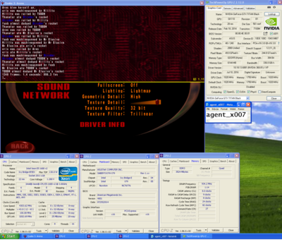

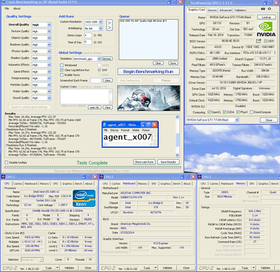

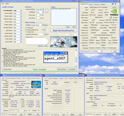

Reply 117 of 241, by agent_x007
Throwing more cores/cache at the problem 😀
3DMark 06 : LINK
^Air cooling (reference GPU)
Crysis FullHD (gpu_benchmark) :
354.92 KiB
4283 views
Crysis FullHD + 16xQ "Assault" (gameplay) :
400.29 KiB
4283 views
Quake III Arena (1024x768) :
782.28 KiB
4282 views
