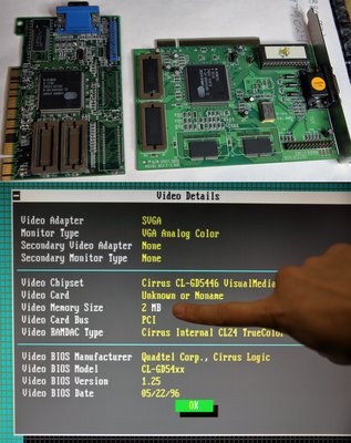

I would also thank Gdjacobs for giving me the idea to mix the ram of an inferior card and add it to a good one (picture quality wise). It really only allow my to notch win98 from 800x600 to 1024x768 at 16bpp, but It was a fun operation. Because I am so happy it worked (and quite proud) I attached a picture. (but beware, so many chips are 21 pins wide and not 20)

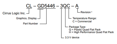

Searching for the ISD driver again I stumbled on the CL-5446 Technical Reference Manual so I found some interesting information regarding the chip nomenclature. Unfortunately both of my cards are A revision which mean they are not pc97 compliant. Maybe in a non retro-computing, or targeting a more recent era, context it would matter. Still it dont explain the BV following the 5446 number. Hope if I ever find out what it mean it wont be another deception 🤣

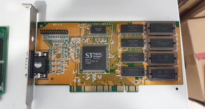

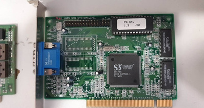

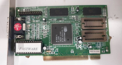

Hello, and sorry to post on and revive the thread here, but my friend actually has the attached cards in which I opted for the CL-GD5446BV-HC-B from all of them..

Regarding the CL card, how much RAM does it come as a standard / unpopulated ?
Are the socketed RAM found on the S3 Virge compatible with the CL one ?
Thanks in advance!

I would like to answer those questions, but the photos are not good enough to read the model number of the RAM chips on either the Virge card or the CL card. I expect the Virge card to have EDO RAM (I am unsure whether it still supports FPM like the Trio64 did), but I don't know about the CL card. Please post the model numbers of the RAM chips. The capacity will be the same. All of those chips are 256K x 16 chips, that is 512KB per chip, and both cards operate the memory at 5V. The S3 Virge is 2MB soldered + 2MB in sockets. The Cirrus card has 1MB at the moment and can be upgraded to 2MB.

I will take a sharper image of the S3 Virge one.
Also, would this card be upgradable to 4MB as shown here in the link ?

The S3 Virge pictured already has 4MB

2 MB is good enough for DOS games. 4 MB in your situation would be only useful for enabling 1024x768 at 24/32bpp video mode.

No, it won't be. Those memory chips are mostly universal on all those cards, and contain 0.5MB. The 5446 cards contain 2 or 4 chips, so they have 1 or 2 MB. 4MB requires 8 chips, like on your Virge card.
