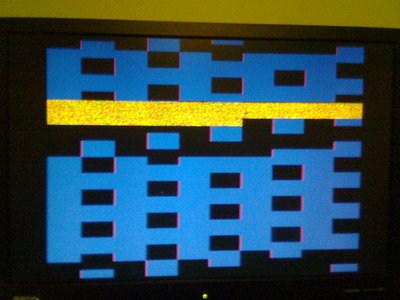

So I've tried everything I can think of. Long searches online provided no answers.
I got a Typhoon 3DMax and at first I honestly thought it was broken. Checkerboard graphical errors abounded in GLQuake and 3DMark99. I've tried three different Socket A motherboards now, with either SiS or VIA chipsets, both in a case and in an open testbed, and in different PCI slots. I've tried multiple AGP cards in tandem with it, GeForce 256, Rage Fury MAXX, Radeon SDR, 9700 Pro, and Voodoo 5. I've wiped all other graphics drivers from the system, and ran Driver Cleaner Pro for each vendor.
I've tried several different drivers for the Voodoo 1, including the four built into Windows 98SE, the last release from 3dfx (v3.01), a previous release from 1998 (v.2.16), a Diamond Monster 3D driver I can't remember the version of, and the custom IceMan Win9x driver, all from Falconfly.de. I ran DCPro in between each. The card is seen and detected by PowerStrip and DXDiag just fine.
In my XP system with its unusual ULI chipset, I just slapped it in with a 9700 Pro, installed a third party XP driver, and it ran GLQuake, Quake II, and Rollcage flawlessly. No effort at all.
The only thing I haven't done is wipe my 98 system's hard drive and start with a total fresh install. Currently I'm running the Unofficial Service Pack 3.56 with DirectX9c installed.
What do I try next?

The 3dfx Voodoo 1 generally does not like cpu's above 600mhz, hence the checkerboard pattern. Lower the cpu speed if you can all the
way down to 500mhz, that worked perfectly for me.
Some people have had success with cpu's up to 1 ghz, but that probably depends on chipset, drivers, etc.

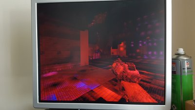

Having the same issue with my canopus pure 3D. First off with a s7 pentium 200mmx s3 virge, now a slot pentium II 333mhz no luck.
Only tried it with s3 cards though (trio64/savage 4 pro agp). Must have wiped and renistalled windows 98se about 5 times now. Tried the canopus official cd, third party and other manufacturers drivers.

Did quake look like this?

Reply 6 of 24, by Richie31
Reputator wrote:
No. If you click "GLQuake" in my post you can see a screenshot. It wouldn't run at all.
Ah yes i see now.
Well actually the picture i put up was Quake 2 but wondered if we were having the same issue. Half of people tell me its a driver issue the other a broken card.
Im as stuck as you are!

What imperious said: Voodoo1 cards generally do NOT like fast systems/cpu's.
I have a lot of these cards and not a single one would work on my Tusl2-c board with Tualatin cpu. Run fine on slower systems. Above 450mhz cpu speed can generate problems. But there are people that have no issues on fast p3's.
So just test your card on a p1 or p2.

Reply 10 of 24, by Reputator
The Tomb Raider demo in DOS does the same thing. Looks just like the GLQuake screenshot.
I tried lowering the FSB down to 100MHz. Didn't help. Then I lowered the clockspeed to 600MHz, which didn't work either.
On a side note, apparently my Shuttle AK35GT2/R let's me change the multi on my 1700+? Not sure how, but I confirmed it.
This Voodoo just hates my 98 machine. Meanwhile back in XP land, I tried Unreal on it yesterday and it runs like a dream.

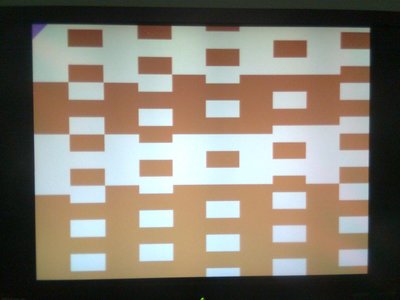

Thanks for the video. I think You should try and lower the multiplier all the way down to 5.0x as I have occasionally had the
checkerboard pattern occur at 600mhz.
Maybe there were some software fixes in Windows xp that sorted out the issue.
If there is a way to lower the ram speed, try that as well.

Reply 17 of 24, by Imperious
Here You go, I made a video that shows what I'm talking about. This game, Whiplash (Fatal racing) is running in pure Dos mode.
https://youtu.be/tpoWllNVOtE
Reply 19 of 24, by Reputator
This seems to pretty clearly prove that CPU clockspeed is the issue. My problem almost exactly matches your results. Unfortunately my setup doesn't allow me to go as low as 500MHz, but that might be the magic number.
So more than likely this will require an entirely new system. But for now I'm pretty happy with how well it works in my XP system. Hell, maybe I can install Windows 98 on it!
