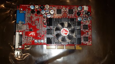

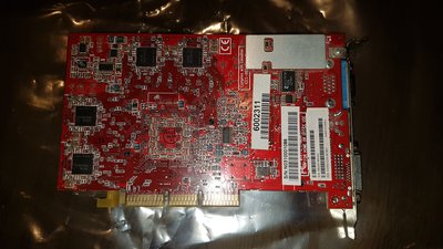

Does anyone recognize this graphics card?
Also I would like to know if I can put it on any motherboard that has AGP slot like Asus P2B or would there be a problem with not enough power through the AGP slot?

That's a Radeon 9700 Pro (see below for possible correction). Power shouldn't be an issue but you have to use a floppy power connector (see top right side of the card). It should work in any AGP 4x/8x slot and there are drivers for Windows 98 on AMDs website.
Should work fine on the 440bx chipset you mentioned or any other board with an AGP slot from the era, assuming a decent enough power supply with a spare floppy power connector.

Reply 2 of 15, by The Serpent Rider
That's a Radeon 9700 Pro.
It could be Radeon 9500/9700/9700 pro or even lucky version of Radeon 9800 SE. There is also high probability that it's dead, if not tested before.

The ATI PN up top cannot be used to determine what the card is. IIRC, it's actually the board PN. Since the earlier 9500/9700/9700 Pro all share the same layout, it could be either 3.
However, since your picture is clear, I can see the memory is PN K4026323RA-GC2A, which means its Samsung -2.8ns memory. So the chances of it being a Radeon 9700 Pro is quite high. Most vanilla 9500/9700 have 3ns or slower memory.

It's a Radeon R300 card. If it's a 9500 you can easily mod it to a 9700 / 9700pro. Performance of the 9700 is close to a 9800 pro.
