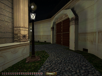

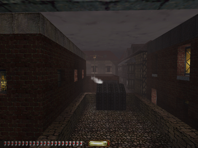

Reply 69 of 553, by GodsPetMonkey
Warlord wrote on 2021-08-31, 11:05:
Thrown in some other cards like savage 2000 and stuff like that to see if anyone else besides 3dfx can render the game properly. Sounds likes a project for collector since most people don't have all the cards.
I have a few cards, and as a Thief fan I did do some testing for my own benefit some time ago, but I never bothered with a Savage (though I only have a 16MB Savage 4 Pro...). So I gave it a shot, and... actually, it's visually very good!
Attached are screenshots from the 'First City Bank and Trust' and 'Life of the Party' missions. The Bank shots have starry sky, electro-lights and colourful textures, Party shots show fog-table. As a reference point I have first attached screenshots using a Voodoo 3, then the Savage 4.
Savage 4 renders the stars, so that's a plus. And it has a transparency effect on the fog that isn't there for the Voodoo 3 (or any other card I have tried actually). I think it looks pretty good actually, the fog effect is still there, but not as heavy (and so you can see the sky). In the screenshots the fog looks pinker for the Voodoo 3 then it does on screen (same thing happens for Nvidia cards too).
The downside? Performance on the Savage 4 is atrocious; it's a terrible framerate - granted I tried at 1024x768, so dropping the resolution would probably help. I don't have a Savage 2000, and it's extra grunt may help out too, but the experience is much nicer performance wise on the Voodoo 3 and TNT (1 or 2).
It would be interesting to know if the Savage 4 is rendering the fog correctly, or if it is just another quirk of S3's design. Every other card I have tried gives fog like the Voodoo 3 (except ATI cards where fog table isn't working), so it would be odd if LGS developed it around the S3.

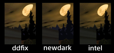

Sadly, Thief 2 The Metal Age will remain as the game that cannot be restored in pristine retailed CD condition and preserved on QEMU VMs on modern systems. Mainly to blame the game unusual technics in using 8-bit palettized textures and fog in Direct3D. WineD3D would render the game just the same as typical modern GPUs, no fog and stars on night sky. For the stars on night sky, using "enhanced_sky 0" would bring back the stars but rendered differently. Otherwise, the originality of retailed CD game would have been restored in QEMU VMs including the support for EAX sound effects. The demo doesn't work with DSOAL EAX but the retailed CD full game, at 1.07 or patched to last official 1.18, detected and enabled EAX with DSOAL.
Perhaps, that's the reason both GoG and Steam go for NewDark for the game re-releases. NewDark also brings native OpenAL EFX support for 3D positional sound effects. So that relieves the need to poke through DSOAL for EAX. I guess NewDark would have addressed all the graphics rendering shortcomings as well. Otherwise, requiring past generation GPUs from 10 year ago to enjoy the game experience in originality would not hold for long.
Reply 73 of 553, by vorob
bloodem wrote on 2021-08-31, 11:27:
I have most cards (collector here), however, Thief 2 is something that never interested me in any way, shape, or form... 😁
That was painful to read since Thief (and the whole immersive sim approach) is the main game of my life.
Back to the topic. You are absolutely right, no way to play the original game on modern hardware without using third-party stuff like:
ddfix, a pre-newdark way to fix the game. It was intercepting calls for old hardware and redirecting them to modern hardware.
newdark, an updated thief engine based on original source code.
QEMU or PCEM (https://youtu.be/Qm1swUfqDeA)
While NewDark is the best possible way to enjoy Thief II today I still miss dithering from old hardware. Textures now have an obvious gradient that was softened by dithering back then.
199.36 KiB
2718 views
Original look, with Dithering
94.73 KiB
2718 views
NewDark
I must say that on a real screen these dots are not so obvious, and on 1600x1200 are just invisible.
64.84 KiB
2718 views
Thief II can be played properly on:
NVIDIA - Up to FX videocards. Geforce 6 is broken already. All GeForce miss stars due to driver compatibility (as I understood), but that's not a big issue for me.
ATI - Up to DX10 cards, so my ATI X1900 display Thief II properly, with stars, dithering, fog, and so on.
Intel - Displays the game properly even on i7 processors, Intel 4000, and 5000. Even on Windows 7. With stars, dithering, and fog.

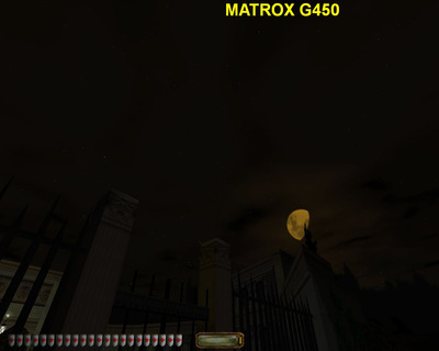

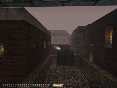

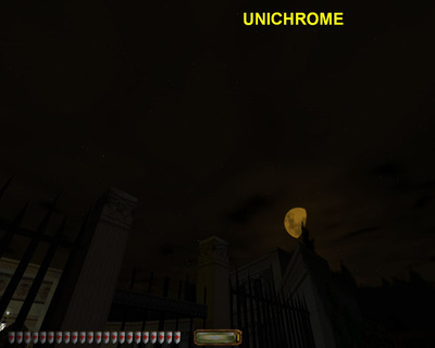

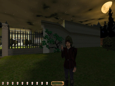

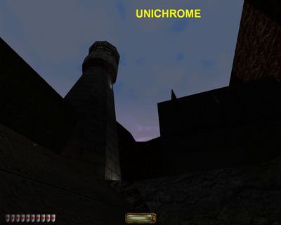

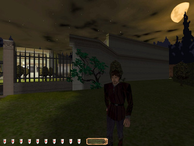

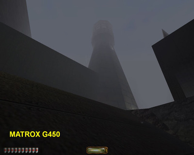

I tried scenes by JJ from Thief2 on the GPU Matrox G450 and Via Unichrome (KM400A). The stars in the sky are visible in both, but Unichrome is surprisingly lacking in fog - yet Savage4, from which it originates, displays it correctly.

Reply 79 of 553, by Joseph_Joestar
Ydee wrote on 2021-09-05, 10:53:
Nice work! Looks like we can add the Matrox G4xx line to the list of cards that can render Thief II correctly.
Interesting findings about Unichrome as well. It could be that S3 decided to implement some cost saving measures and cut table fog support. Or maybe there's a hidden option for that somewhere in the registry, if not the driver control panel.
