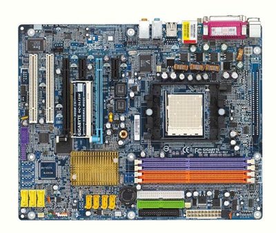

In sorting some of my projects... I have one that is a bit far flung for me and I'm on the fence if I'm going to have a go and execute it myself or pass it on for someone else to have a chance.
As said, it is a bit far flung and outwith my normal scope... I tend only to fumble around with 386 / 486 hardware, though this system is a PCI-E system.
My question though is this...
if you could choose to have two PCI-E graphics cards running SLI on the below motherboard... which two would it be? ... and why?
EDIT (15/04/18)
Didn't realise there may be limitations to the graphics cards able to run on the system. The motherboard is a GA-K8N Pro-SLI shown below: -

Seems like a super vague question, I'd would want to know more about the motherboard and possible CPU's it would be running with so as not so suggest something extremely out of balance.
BUt here's some ideas:
Cheap, common config, slightly retro: 2x 9800GT's. Evga recently had it's Bstock 9800GT's on sale for $18 FS, and if history is any indicator will likely do it again this Wednesday.
Interesting: 2 Quadro's that support SLI and have an unusually memory configuration. Some examples: FX5500 (1gb 7900gtx) FX5600 (1.5gb 8800gtx), FX5800 (4gb GTX285), I could keep going but cost is increasing. You get the idea.
Cheap and modern: 2x GTX460. This combo is cheap and will get you DX12 support, although I doubt it would play any DX12 game with acceptable framerates.

Reply 4 of 27, by 386_junkie
Hey guys,
Excuse my ignorance... PCI-e is new technology to me.
The motherboard the system is using is a GA-K8N Pro-SLI: -
https://www.gigabyte.com/Motherboard/GA-K8N-P … o-SLI-rev-10#ov
From the manufacturers site: -
"NVIDIA nForce4 SLI offer blistering graphics performance with the ability to bridge two NVIDIA SLI-ready PCI Express™ graphics cards! The SLI design takes advantage of the increased bandwidth of the PCI Express™ bus architecture, features hardware and software innovations within NVIDIA GPU (graphics processing unit) and the NVIDIA nForce4 chipset.
Any idea's as to which PCI-e cards would best be paired together? I assume they both have to be the same as each other.
Thanks in advance.

SLI is only useful in the following situations:
* To get the absolute best performance from top-of-the-line hardware, where even the fastest single GPU is not enough
* If you purchased a specific GPU at a time (due to budget constraints) and now want to upgrade the performance of the existing setup (for example you can get another GPU of the same type cheaply)
In all other cases, it is better to just get a single, more powerful card.

Authentically best option would be Quadro FX 4400 SLI (GeForce 6800 Ultra 512mb) or Quadro FX 4500 SLI (GeForce 7800 GTX 512mb).

What's the most powerful GPU today? Say it's the GTX 1080 Ti? Well, if you want performance on a level beyond what a single 1080 Ti can provide, you buy two (maybe even three) and put them in a SLI setup. This gives you the absolute best performance, assuming the rest of the system will not bottleneck them.
As soon as you leave the bleeding edge - SLI loses its value. For example, suppose a GTX 1080 is about twice the performance of a GTX 1060? Well, in most practical cases (there may exist some corner situations), it's better to just get a single GTX 1080 than a pair of GTX 1060 in SLI.
Unless it's like my other example - you bought a GTX 1060 because you didn't want to pay for a 1080, then 1-2 years later you feel like upgrading performance, and can get another 1060 cheaper than an 1080 (obviously) and don't want to bother with swapping out and selling your existing card.
That's it. Setting up SLI for an older platform has little practical value - it's only for the fun of experiencing something different.
386_junkie wrote:
What i'm trying to ascertain is... with a Socket 939 system, with the fastest CPU available to it, where in the range of PCI-e cards would suit best? ... would the system support more a mediocre PCI-e card, or would it be able to support a high end PCI-e card?
You are talking about a 12-year old platform, whether the fastest CPU is an outdated-arch dual-core, yes? Obviously the current top-of-the-line cards will be severely bottlenecked. Heck, you are talking about PCIe 1.0, whereas today's platforms are PCIe 3.0 (4 times faster bus).
So if you really want SLI for the fun of it, something retro, almost period-correct and inexpensive is perhaps the 9800GT that BinaryDemon suggested, or one of the Quadro setups suggested by The Serpent Rider.

GTX 1060 doesn't support SLI (DX12 PCI-e multi GPU support is needed for it).
If you want good SLI for this platform, I recommend 2x GTS 450 or 2x GTX 650 (Ti).
Why :
1) Power usage and GPU temps are non-issue (single 6-pin since those are low TDP cards)
2) Best from cheapest longevity (8800/9800 a.k.a. "bakin' adventures 101")
3) Good performance with FX-60/Opteron 185 (even stock)
4) Win XP compatible (900 series and later aren't)
5) Available in single slot design
6) DirectX 12 support (you will need a bit more modern platform however, since Socket 939 doesn't support DX12/Windows 10)
Regardless, just like other said - single GPU will be better.
You don't need the exact same card for SLI to work.
Simply get two of the same model with the same clock* speeds.
*If you can't you can mod vBIOS of one of the card to change default clocks.
I'm not sure if NV driver can do it for you...
