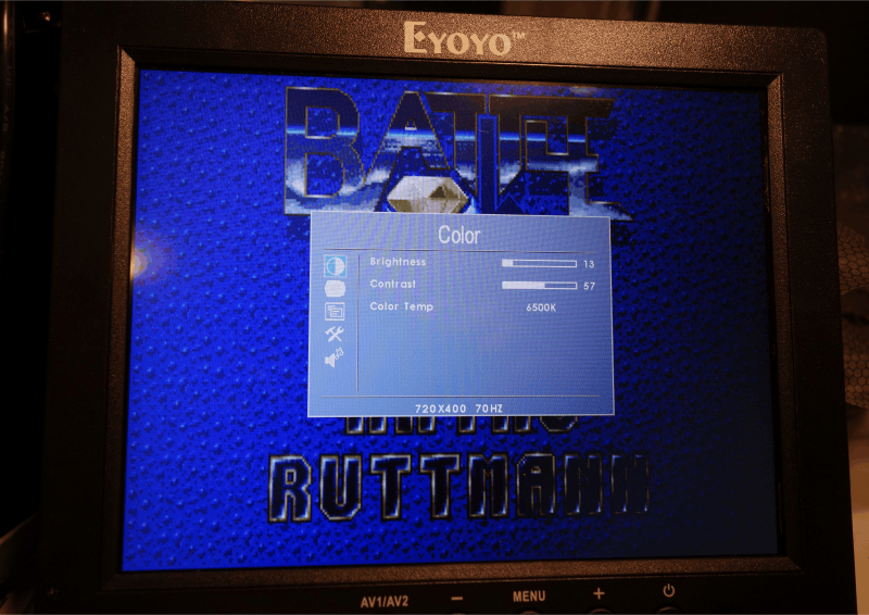

The monitor is an Eyoyo S801H with 1024x768 resolution (the S801H is also sold with 800x600). It has VGA, HDMI, composite and Ypbpr input support, but VGA is the main interest here. It claims only to support 800x480, 800x600 and 1024x768 input at 60Hz, but that's far from the whole story.
Firstly the panel is a TN pig, with remarkably clear and crisp image quality if you are directly in front of it, but with major deviation of hue and saturation as soon as there are any angles involved. But this isn't a screen for long hours working or enjoying films, so that doesn't really matter.
What does is the input. With HDMI it's what you would expect. With VGA, it can do quite a bit more. I've taken a few pictures to illustrate, but I couldn't get my damned camera to focus on the screen, so apoligies for the fuzzy pictures.
Firstly it handles DOS text modes fine, here's the POST of my Tyan Tsunami:
It does a better job at scaling and centering than my high-end Iiyama CRT, but takes its time to get there - the first few seconds at a resolution/refresh rate are visibly wobbly as the algorithm searches for optimal settings. It also takes a while to lock onto a signal when changing modes- so not ideal for the very first POST messages.
Then the all-important 720x400@70Hz:
Looks good enough to me 😀
Finally I booted into Windows 98 and played around with different resolutions and refresh rates.
This was interesting. Basically it accepted any resolution I could feed it, although anything over native (i.e. 1280x1024) looked awful. Interpolation at lower resolutions wasn't too bad. The interesting bit was refresh rates. It accepts input up to 75Hz. With 85Hz it gives an out-of-range error. Now I'd expect that its native frequency would be 60Hz and that there would be no visible difference above that. Wrong! Something looked different at 70 and particularly 75Hz. I used the display of my camera as a poor man's stroboscope and it helped show clear differences in displayed refresh rate. This screen actually goes up to 75Hz output!
All in all, it does the job I bought it for: a tiny but usable screen for installation, troubleshooting etc. I already knew that, but now I can also say it's great under DOS in both text and graphics modes, and that if you do want to stare at it for hours, you can get it to give you 75Hz. Not bad for a few EUR from AliExpress 😉

Out of curiosity, what are you using to test 720x400@70Hz? I have a few devices I want to try at this resolution to see if they work.
Reply 17 of 20, by Malvineous
720x400@70Hz is standard DOS text mode, which is why it's so important. Many BIOSes use the mode for the setup, and on most video cards, the 320x200 video mode that so many games run in is scanline-doubled and shown in the same 720x400@70Hz mode. It's basically the mode you spend 90% of your time in on a retro PC!
Reply 18 of 20, by dionb
I used Battle Isle, as it was the first DOS game I found that would run on the testPC without sound cards (the rest are all configged for SBPro 2.0 and/or General Midi and didn't want to run with no sound devices). But any (non-VESA) DOS VGA game would do the trick 😉
Actually it's not 720x400@70Hz, but 640x400@70Hz (upscaled from 320x200). See this post for a more detailed explanation:
So if you are playing a DOS video game which uses IBM mode 13h (320x200x256 colors), then it will display with a vertical refresh rate of ~69.9Hz, which your LCD monitor may 'see' as 720x400 @70Hz (dot clock 28.322MHz) because it is 'broken'. The LCD monitor should 'see' the video input as 640x400 @70Hz (dot clock 25.125MHz) but it may be that LCD monitor manufacturers would display VGA text modes 03h/07h and graphics mode 13h identically by hardware scaling.
