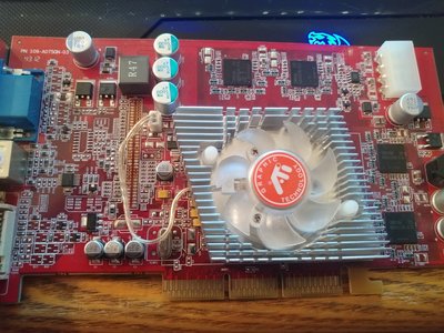

So my 9800 Pro seems to be running at 324/400 instead of 380/630 anyone seen this, did I get a bad 9800 Pro, I can't imagine anyone counterfitting these cards so late in the game.
Also when I set it to 9800 Pro stock clocks I throw memory erros left and right
Reply 1 of 35, by candle_86
the ram chips.
K4D263238G-VC36
according to the data sheet this ram is max rated for 275, so instead of a good card I got a fake card

Reply 9 of 35, by candle_86
honestly its a shame I don't have a BGA rework station, my Quadro FX3000 is dead because i cracked a memory IC, but if i had one and a mask I could just transplant it's 2.2NS Ram onto the 9800, and swap the bios to a 9800 Pro with hynix instead of samsung ram

Reply 13 of 35, by candle_86
1.91 MiB
590 views
Thats the card I got sent
Reply 14 of 35, by The Serpent Rider
That's clearly some third party rip-off of Radeon 9600/9800 PCBs.
That card is not built on a Radeon 9800 PCB, not even a 9700 PCB. It is actually the worst Frankenstein PCB I've ever seen.
Can you please lift the cooler and check the GPU for me?
Reply 19 of 35, by appiah4
candle_86 wrote:
already did, it's marked R350. But its also unstable as all get out
It is market R350 but I'm not so sure that it actually is an R350 😀
