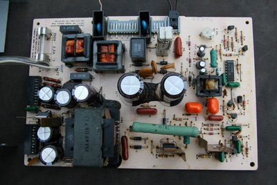

Guys,
I recently aquired a complete IBM PC AT 5170 w/ 5154 Monitor and IBM AT Keyboard in a lot. I knew that the monitor needed repair as the seller told me when he was testing out the monitor it "released its magic smoke". Anyways I was hoping a few caps would be enough to revive the beast so I picked it up. I really should have done this myself but I've never worked on a monitor PSU before and everyone told me that I could kill myself working on it. So I took it to a repair shop.

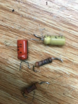

The owner has had it for a month now and has been slowly working on it, hes not familiar with this old of a CRT so I've been trying to field questions for him to help out. He's pulled and tested a few parts and replaced all the caps but he's not sure what value the resistors should be or what capacity a certain component should be. Does anyone have a schematic for the PSU of a 5154? If not perhaps someone who has one with easy access might take a look and tell me what the values of the following items are:
R37 Two resistors blown, can't tell from the resistors what the values are.
C6, what is the value for this capacitor? He's guessing 250v?
I'm posting pictures below of the board, and the resistors, and maybe someone can help, thanks!

Reply 1 of 22, by Shagittarius
I was able to figure out what C6 is here's the cap list incase anyone lands here in the future:
https://docs.google.com/spreadsheets/d/1opYmx … 1nXQ/edit#gid=0
I still don't know what R37 is, I haven't been able to find any pictures of the PSU where I can see this component. I can't even find where it should be on the board. So if anyone knows that would be a big help.
Reply 3 of 22, by keropi
These pics are not good to identify components not to mention a burned resistor is tricky... Your best bet is the circuit diagram found here: http://minuszerodegrees.net/5154/doco/5154_documentation.htm
I am on mobile and can't check it atm but it seems like it would list component values.

Reply 6 of 22, by Shagittarius
Well, It seems to have everything but I still dont see an R37 in that documentation so maybe the guy mistyped that number. At any rate I sent him the schematics he should know better than I do I hope.

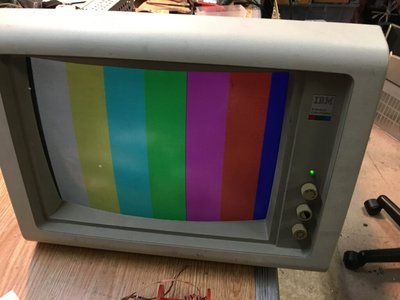

Reply 7 of 22, by Shagittarius
A Happy Ending!
171.55 KiB
2321 views
It Lives.
Look at those scanlines! I'm in love!

Reply 9 of 22, by Shagittarius
After 10 minutes of running it with an IBM CGA card it smoked again. I'm wondering if this is a different issue than before as it seemed to have a problem with all the half bright colors in text mode. All the colors that were half bright were barely visible and the gray halfbright had a somewhat red hue to it. However all the full bright colors were there and very bright, I had to turn down the brightness the monitor was so bright with those.
I also ran through a few games, Leisure Suit Larry and Police Quest in RGB CGA mode and all those were fine, which again leads me to believe somehow the half bright colors were the problem since there are no halfbright colors for CGA in those graphics modes as far as I know.
I'm going to give the guy a call and take it back to him again and give him another chance to look at it. When I was in the games the monitor looked great, It's too bad it smoked and text mode was a little odd. Maybe next time it will work completely and not smoke almost immediately.

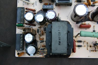

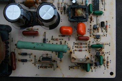

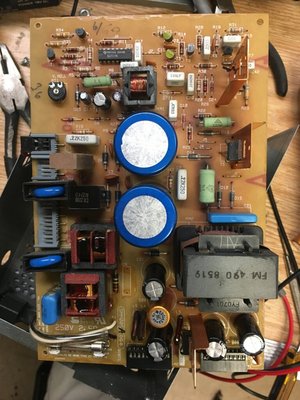

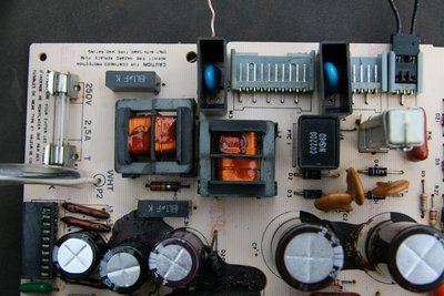

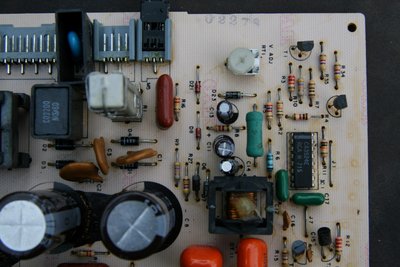

Reply 14 of 22, by lowlytech
I can't find R37 either on my power supply. I took some close up shots of my power supply that has been recapped.

Reply 15 of 22, by Shagittarius
Yeah the repair guy I got said that R37 was actually a dual set of resistors, I didn't get a chance to ask him to show me but he said the schematics helped him figure it out. I don't know if that helps you at all.
Reply 16 of 22, by lowlytech
Well I still have my 5154 halfway torn down, let me skim over the mainboard, crt neck board, and video board too and see if R37 is somewhere on one of those boards
Reply 17 of 22, by lowlytech
I am sorry Shagittarius, I can't find R37 anywhere at all on any of my component boards. If you knew the physical location of the original part I would be happy to let you know what is in that place on my 5154.
Reply 18 of 22, by Shagittarius
It's alright, thanks for your help, it might have been an errant request. I'm going to talk to my guy again tomorrow and send him the picture of your 15kV tripler. Where did you get the replacement for that? I think mine probably needs that one replaced too as my half bright text was discolored and dark sort of like yours.
Reply 19 of 22, by lowlytech
Maybe your tripler just needs adjusted, unless you already tried that. The screen adjustment that also seems to coincide with focus adjustments is that potentiometer that is on the board that connects to the CRT neck.
If that doesn't help, I ordered my part from tedss.com here is the direct link..
https://www.tedss.com/2023000565
