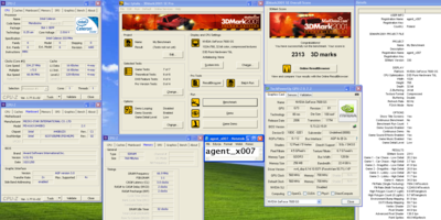

Reply 8 of 8, by agent_x007
457.17 KiB
1064 views
7600 GS @ GT + 93.71 + Celeron 333A.
Don't know how/why FX series might require SSE when even 7000 series doesn't.
