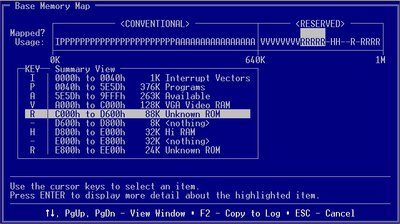

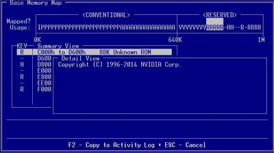

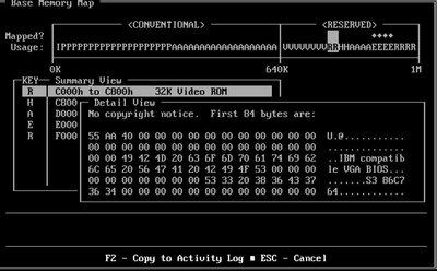

d) In past we recommendaed to Use CheckIT program - SystemInfo->Memory Map -> find Videp rom and read the size, you can press Enter on to check Videocard ROM vendor info.. but FalcoSoft found that sometimes is report size wrong too big..

Reply 13 of 54, by ruthan
Falcosoft wrote:
Make sure you do not compare results you got with VBSize vs Bios File (Bios dumps) vs Checkit.
Ok its more complicated than expected.
Falcosoft wrote:
VBSize and debug method report the size of the memory payload. A BIOS file contains headers, paddings, parts that are irrelevant for DOS etc. so it's usually bigger than memory payload. Checkit does not seem to be able to differentiate between Video BIOS Rom and other option ROMs loaded above the Video Bios Rom but reports it as a continuous occupied area. So e.g. if you enable AHCI support Checkit may report a bigger occupied 'Video BIOS' area starting at C000 segment. And if you peek the memory area it reports the Video Bios at the start but it cannot tell where the Video BIOS ends and where other option ROMs start.
To results in first post i added which tool was used to extract info, at least for now i dont have any Bios dumps, but i would expect that it would be just 1:1 ROM copy.. if understand correctly you are saying that now whole ROM could be used for Vbios bios?
Checkit - it could have some bug, i didnt excepted that.. i will try to compare some CheckIt and VBsize results and we will see. For these who dont know CheckIT output looks like this.. Often there is at least manufactor name in message header.
59.22 KiB
1830 views

@Edit:
Problem with Checkit: As I said in some cases Checkit can report video bios + option ROM together as one continuous occupied area labelled as 'Unknown ROM'.
In this case the real Video bios size is actually less than 64 KB but AHCI option ROM is enabled. Someone can misunderstand this and falsely believe that in this case video bios is 88 KB.
112.23 KiB
1791 views
It can be misleading since when you peek at the memory area you can see the sign of a video bios rom (since it's at the start of the address range):
71.09 KiB
1791 views
If you disable AHCI in the above case Checkit reports 64 KB 'Unknown ROM' that is still not fully correct for the real video bios size and it still cannot recognize 'Video ROM' . So it seems Checkit has problems properly detecting with video bios sizes bigger than 32KB.
