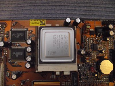

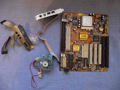

1397 views
I just received this today. PCCHIPS M590 and K6-III 400 CPU. They were sold as a working pair, so I will see how it goes, I suspect I will drop back to a Cyrix MII 333 on this board as it could only manage 90MHz FSB at best & I have had good results with this SiS chipset and Cyrix before, be interesting to see how it fairs as it is though.
Best,
