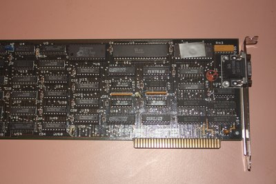

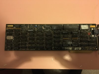

I've got a STB Systems ISA 8bit Video card that i would like some info on. I'm planning on using it in my "5160 XT Clone" pc. I believe that it could be a EGA Card, but it only outputs in MONO. I Tested it in my DOS Machine and it only comes out as MONO. It Does have some DIP Switches on the Card, but i have no idea what to set them to. The only other thing i could work out is that it was made in 1984. and it has what i think could be a EPROM chip under the Silver Tape

Hi and welcome 😀
Nice old card. But probably not an EGA card. It looks a lot like an IBM MDA or Hercules clone, based on the same Motorola 6845 chip, or rather a clone in this case ("SY6845"). Being MDA/Hercules would explain why you're only getting mono output... there are a few STB 8b ISA cards in TH99 but nothing that maps onto this one.
What makes you think it would be EGA?
EGA was released at the end of 1984, but wouldn't become common until a year later. Generally EGA cards either had more controller chips than MDA/CGA/Hercules, or a smaller number of more integrated ones.
In any event it seems to be working correctly and would be a good match for an XT, so not all bad.

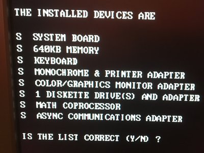

For a bit of fun i ran the Diagnostics Disk for the computer and it came out with this
1.24 MiB
1716 views
Before it came to this screen, it asked if a monitor was attached to every Display adaptor which i thought it was strange as there is only one card in the computer. I Highly doubt it, but could the display adaptor have two modes? ie CGA and MDA? or is it a glitch on the Diagnostic Software.
Reply 3 of 12, by dionb
No, that's very possible. Famous examples include the Tulip DGA board (with a nice external metal switch to switch between MDA/Hercules and CGA) and the ATi Small Wonder (as the name says, a very small card with dipswitches to select; it also has analog out making it an excellent all-round retro device).
But I don't think that's what's going on here - no board that I'm aware of does CGA and MDA at the same time, moreover your monochrome adapter apparently also has a printer port (common in the day), which your pic doesn't show, not even a header for it. So, I suspect that this board is CGA, not MDA (very possible as CGA uses the same Motorola 6845 chip), and those dipswitches are set for mono output. And you have another card in the system which offers MDA (+ possibly Hercules) and that printer port. MDA+CGA configs weren't exactly common, but the two cards could coexist and the combination was used for say showing Lotus 1-2-3 tables in mono on the one screen and graphs in glorious (low-res...) colour on the other.

Reply 4 of 12, by bakemono
I was wondering about that as well. The pic is a bit fuzzy but it appears to have 16KB RAM, 22MHz crystal, two chips that could be ROMs, no composite video or printer port. Those are not the characteristics of either a CGA or MDA card. Maybe it is some kind of combo. The text in your pic certainly doesn't look like CGA resolution, but what if you attempt to switch to a CGA mode with MODE CO40?

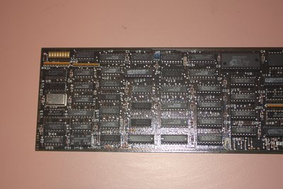

Ok, first off here is a better photo's of the card.

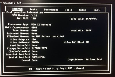

i also ran checkit on the system and it came up this.

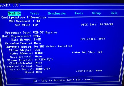

But thinking about what you both mentioned that it could be a MDA/CGA card and have 16k ram instead of the 4k it showed, i decided to flick all of the Dip switches on the card to on and it now shows this.
1.28 MiB
1667 views
So it would appear that this card can either be in MDA (4k ram) mode OR CGA (16k ram) mode. (yes i changed the motherboard switches too)

Hello!
MB81416 = DRAM 16K*4 bit, which means that card has 64 KB, so most likely it supports Hercules graphics.
Try setting the switches to mono, and load MSHERC prior to running CHECKIT - then it should detect it as "Hercules" and run Hercules graphics tests.
However, while both MDA and Hercules use 16 MHz pixel clock, that card has a 22 MHz one - so it must do something more...
There were some "STB Chauffeur" cards supporting 132-column text and 1024x348 graphics - perhaps this is one of them?

Ok i've done a few more thing,
running the card in CGA 40 column mode crashes the system whenever it trys to run checkit
CGA 80 column runs fine (SW1 set to on,on,on,on,on,on,on,on)
MDA Mode runs fine (SW1 set to off, off, off, off, off, on, on, on,)
as i do not have MSHERC.COM, i cannot check or test to see if it has Hercules Mode
However, changing the position of jumper W7 makes the text appear smaller on the screen.
As i cannot find a manual or a part number for this card, i think this is about as far as i can go with it. i'll leave it in CGA 80 Column Mode for now

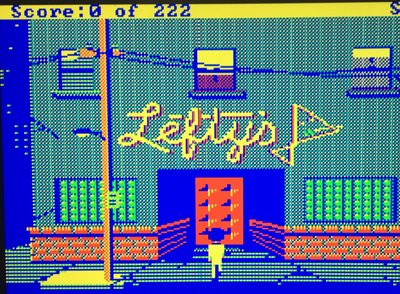

i'm limited to 720k games (No HDD at this stage) at the moment, so here's Leisure suit Larry in Hercules Mode (I think) the mode can be changed in game

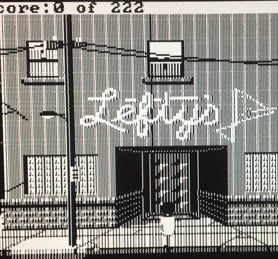

and here it is in CGA
