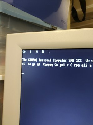

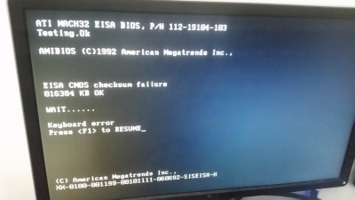

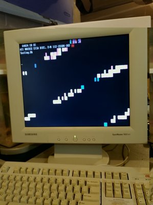

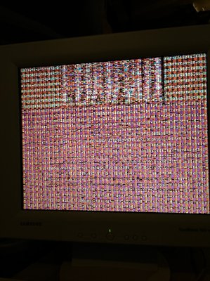

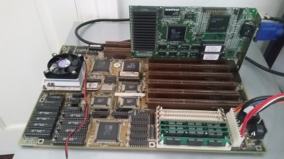

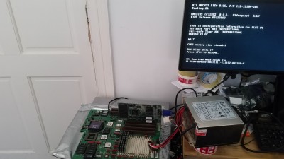

I bought an ATI Mach32 EISA from a seller on ebay. It came in today and is pretty much a $260 dollar paperweight. I'm in the process of initiating a return with the Glasgow seller I bought it from but I doubt I'll have any luck considering my past experience with used part dealers on ebay.
It won't display a full character set and constantly displays character artifacts flashing about all over the screen. The seller included a disk with a EISA config file. I know the EISA configuration menu by heart so I managed to install the cfg file in hopes that it would remedy the problem. Nope. it's just a bad card.
Anyway I was curious as to whether any of you guys have seen anything like this before and is there any chance of me fixing this card.

Reply 2 of 10, by treeman
memory corruption is what comes to mind first, could be any hardware related problem. damaged trace, knocked off capacitor memory chips cracked solder joint or worst scenario the actual memory chip shorted inside
Post some pics of the card back and front of good resolution maybye it will be something obvious

Reply 5 of 10, by slaynmage
The seller accepted the return. I'm going to ship it back monday. Seller was of course convinced that my hardware was to blame but accepted the return anyway. Just to humor the guy I tried the card with different ram, different cpu board, every single combination of hardware removed. The card is just bad.

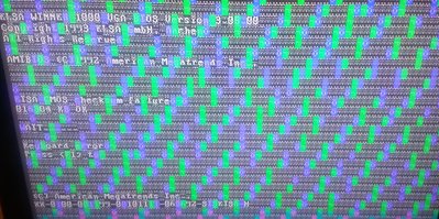

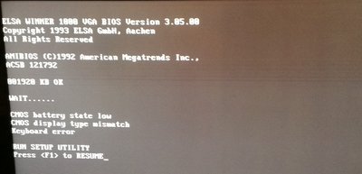

I think this kind of thing comes down to compatibility with motherboards. Not every piece of hardware can be assumed to work and be compatible with every other piece of hardware, especially before the days of "plug and play", and most importantly with OEM's i.e. IBM, Compaq to name a couple. These OEM's were renowned for other off the shelf hardware for not working in their systems, Compaq especially! Which gave rise to most people opting to build custom systems, to allow the user to have greater flexibility and less hardware conflicts.
An example below shows an Elsa EISA graphics card on one motherboard seen as "dysfunctional", but then miraculously working in another motherboard. Makes you wonder why a card works fine in one system but then not in another.

Have you tried the card in question on other motherboards, or has it only been tested on this Compaq system?
