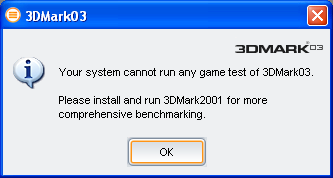

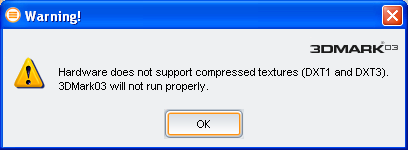

I have a Voodoo 5 5500 PCI in a Windows XP machine with a Pentium 4 CPU. I'm using the the SFFT 1.9 driver. It works well with what I run on it, but I hadn't ever tried running anything on it from the DirectX 9 era...until now. I installed 3dMark03, which is a DirectX 9 benchmark, and it couldn't run.
9.49 KiB
2161 views
10.22 KiB
2161 views
11.28 KiB
2161 views
I also tried the AmigaMerlin 3.1 R11 driver and the 3dfx V1.04.00 driver, and they gave me the same problems.
(3dMark2001 SE runs though. 3D marks: SFFT 1.9: 2510, AmigaMerlin 3.1 R11: 2565, 3dfx 1.04.00: 2516)

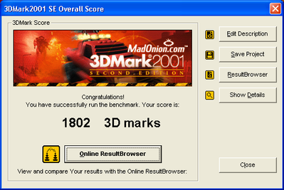

Reply 14 of 15, by STX

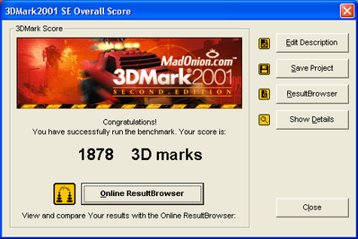

I decided to test the SFFT 1.9 driver on a Pentium III with Windows XP. I removed the GeForce FX 5600 from my Pentium III-S machine and installed the Voodoo 5 5500 PCI. Here are the 3dMark2001 SE results with the 3dfx V1.04.00 driver, the AmigaMerlin 3.1 R11 driver and the SFFT 1.9 driver.
3dfx V1.04.00 😀 :
45.46 KiB
2118 views
AmigaMerlin 3.1 R11 😀 :
45.46 KiB
2118 views
SFFT 1.9 😵 :
133.59 KiB
2118 views
So, I would agree that continuing to use the official 3dfx driver in your machine would be a good idea. The AmigaMerlin 3.1 R11 driver would be a good alternative if you run into problems with the 3dfx drivers.
