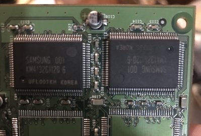

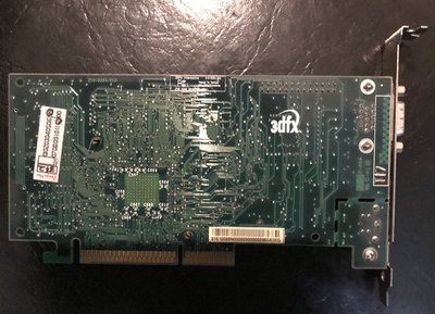

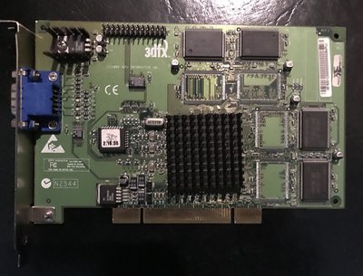

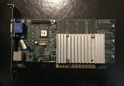

Hi All,
Coming from the Voodoo and Voodoo that *required* a 2D card, and that I was pairing with other 3D cards (Voodoo with Riva 128 / Voodoo 2 with TNT), I pondered doing the same with the Voodoo 3.
With the first card I got it wasn’t optimal since it was a Voodoo 3 3000 but AGP, and so I couldn’t use another D3D card that would benefit most if it was also AGP.
I just got another 3DFX card, this time a Voodoo 3 2000 PCI.
Would this make a nice tandem with a TNT2? Is it worth it? I think the RAMs it has lets it overclock to Vodoo 3 3000 performance level?
Which would you use/leave and why? (This would be for a Pentium III 1Ghz cpu on a Soyo 7VBA133 motherboard).
Thanks!

Reply 6 of 7, by walterg74
So having both a PCI Voodoo 3 (2000) and an AGP Voodoo 3 (3000), besides hoarding/stocking, regardless of whether it makes sense or not for the dual setup, would there be any point in keeping the AGP one, or just keep the PCI one and sell the AGP version?
Reply 7 of 7, by Fusion
I enjoy having a PCI version since it provides more compatibility with different systems and the performance difference is literally 0. Which is a bonus.
That 2000 will clock to 3000+ speeds no problem I bet. Just add some cooling on the heatsink or blowing towards the card at least.
