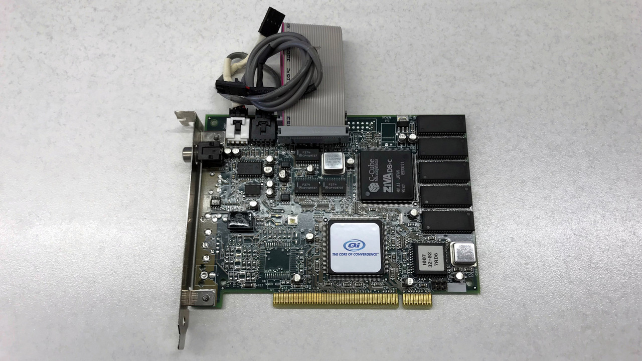

Reply 1 of 1, by appiah4
This came installed alongside a Riva 128 in my Dell XPS D333 which shipped with a DVD-ROM so apparently this accelerates DVD Playback. It is connected internally via the feature connector.
More info on the card here: http://www.pennskog.com/cinemaster/hardware.htm
