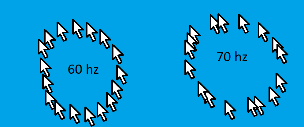

Reply 14 of 15, by lafoxxx
Tried using Powerstrip. Here are results so far:
In Quake and even vanilla (DOS) DOOM refresh rate was 72 and 70 Hz, accordingly (checked in monitor OSD).
This was achieved by checking some box in the program, which tells computer to use this framerate on all resolutions.
The framerate was smooth even in UnrealT, at 75 Hz.
By "Smooth" i mean "every frame had same duration in milliseconds" (as it should be when monitor, GPU, program and OS natively supports this framerate).
BUT
In Windows, cursor movement was twitchy, and looked like this:
This effect was worsening gradually -- depending on which framerate is used.
Probably Windows Explorer only works with _natively supported_ framerates correctly. I don't remember my pointer moving like this when I had a CRT monitor which supported up to 85 Hz at 1024x768.
I also wanted to check if using other monitor (native 144 Hz support) will show same result with cursor, but it refused to run ar more than 60 Hz even with drivers.
Haven't tried the VESA driver yet.
TL,DR:
Powerstrip works flawlessly in games, but not in Windows Explorer.

Well, I am impressed. I was not expecting Powerstrip to be able to affect refresh under full screen DOS in mode 13h , but I guess you learn something new every day . That cursor thing on the Windows desktopis strange, though .
