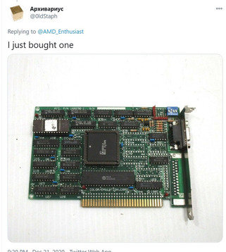

Reply 15 of 26, by Anonymous Coward
Ah, somebody finally found one. Pretty cool.
The IC on there is from the second half of 1986, so it's probably a stripped down version of their Graphics Solution? Maybe kind of like the 1024 series? I wonder if any of the graphical functionality has be intentionally gimped too.
Reply 16 of 26, by Benedikt
Interesting.
So it does have the same gate array, just like I assumed.
It is also not a pure color emulation card, because it clearly has a composite video header and there are too many traces running to the DE9 socket.
There is no 16(.257)MHz oscillator, though, i.e. the MDA/Hercules pixel clock is missing, but the 14.31818MHz from the ISA bus are obviously still there.
720 / 16.257 * 14.31818 = 634.132349142 and 720 / 16 * 14.31818 = 644.3181, which makes perfect sense, since it is a CGA emulation card.
What is intriguing, though, is that it has 32 rather than just 16 KiB of RAM.
I therefore assume that it is in fact a Plantronics + Plantronics emulation card.
Reply 17 of 26, by rmay635703
@Benedikt I believe the idea of that card was that you could switch and choose mono or CGA monitors with the same card
(even though both were CGA resolution for graphics )
I wonder if that is a later rev Color Emulation card and ATI just used the name for their entry level solution?
(See rev4 in the corner? Rev1b was slightly different)
Ah well, maybe when I move I will run into my card again
Reply 18 of 26, by mkarcher
Benedikt wrote on 2020-12-22, 13:24:
Note that it says "Color / Emulation card", not "Color Emulation Card" on the PCB. This could point to the card being a "color card" or an "emulation card", depending on setup.
Reply 19 of 26, by Benedikt
Good point! I missed that somehow.
It just occurred to me that the switch settings might be similar to those of the ATI Graphics Solution.
The following diagram is from its manual. (AGA is Commodore's OEM name for that card.)
55.2 KiB
1495 views
AGA Switch Settings
Assuming that the meaning of the individual switches is the same, the depicted Color/Emulation Card is configured for a "Monochrome or RGB" screen in "Emulation" mode.
The first four switches are missing, but only the fourth would be used anyway, namely to switch composite video between color and monochrome.
So maybe it does not support color composite.
