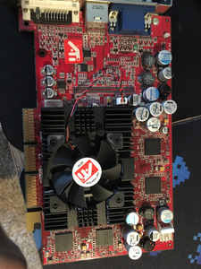

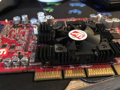

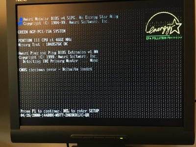

Hi All,
I picked up an untested Radeon 9700 Pro off of eBay fairly cheap and I'm having some issues with it. When I boot it up, I immediately see artifacts all across the screen. I noticed that the GPU fan is not functioning, so I am wondering if it's possibly dead due to that as I don't see any bulging/leaking caps. I'm using the VGA connection.
Funny thing is if I disconnect the floppy power from the card it will boot without artifacts and give the "Your Radeon needs connected to the power..." screen. Any ideas? I was thinking of using the oven trick based on other posts. Also if there are any tricks to getting the CPU fan working again, I'd love to hear it. I'll just disassemble/clean/lubricate it if I can actually get the card to boot without artifacts.
Thanks!

Suggestion:
a) Get a 9700 non Pro from an OEM like Dell as they had lower factory clocks and less chance of having died by overheating .
b) Remove the shim around the GPU core and replace thermal compound/cement (WD40 works relatively well for that) .
c) Optional - replace the thermal solution (heatsink fan combo) with something less anemic .
Reply 5 of 23, by darry
nwsw wrote on 2020-08-08, 22:15:
Thanks, is it even worth trying the oven trick?
If it was sold as working, I would return it .
Even if it works, the oven trick is a short term solution .
Reply 7 of 23, by darry
nwsw wrote on 2020-08-08, 22:26:
Thanks darry! I'm going to skip the oven and try replacing the thermal compound cement and see what happens. I was sold as-is so no returns.
If the card is already borked, that is unfortunately unlikely to work .
One thing you could try is applying pressure to the memory chips while the card is on and see if artifacts disappear . If that works, you may just have some bad soldering needing a reflow around one of the RAM chips .

Thanks, I just repasted it and confirmed it's dead. It actually had more artifacts when I repasted it. 😀 Guess I'll just be on the hunt for a Geforce 6200 512MB.

I would still try looking into other problems the card may have. wile many 9700's have died from overheating and failed BGAs, that may not be the problem, althoug it is likely the prob,en given the fan does not spin . There could be a missing SMD or cut trace somewhere. Or the RAMDAC could be bad so try DVI. And don't toss out the idea of baking the card. Wile baking a card is a often a temp fix, sometimes its lasts for quite some time.

The fan should spin no matter if video ram is bad or not. I think those SMT caps are the reason for the bad video, have had same on GF6200 and others. Someone marked some of the caps with a felt pen (is not typical of any retail card I know of). Return it if you can or fix the fan and replace the big caps, may be cheaper then buying another one that could have same issues. just a thought ...
I've had two Radeon 9800XTs like that, slight flexing the cards "fixes" the artifacts, but it's more than the memory chips themselves - assume BGA of the 9800 is also at fault. Extensive resolder, temp gun fixes did nothing at all.
