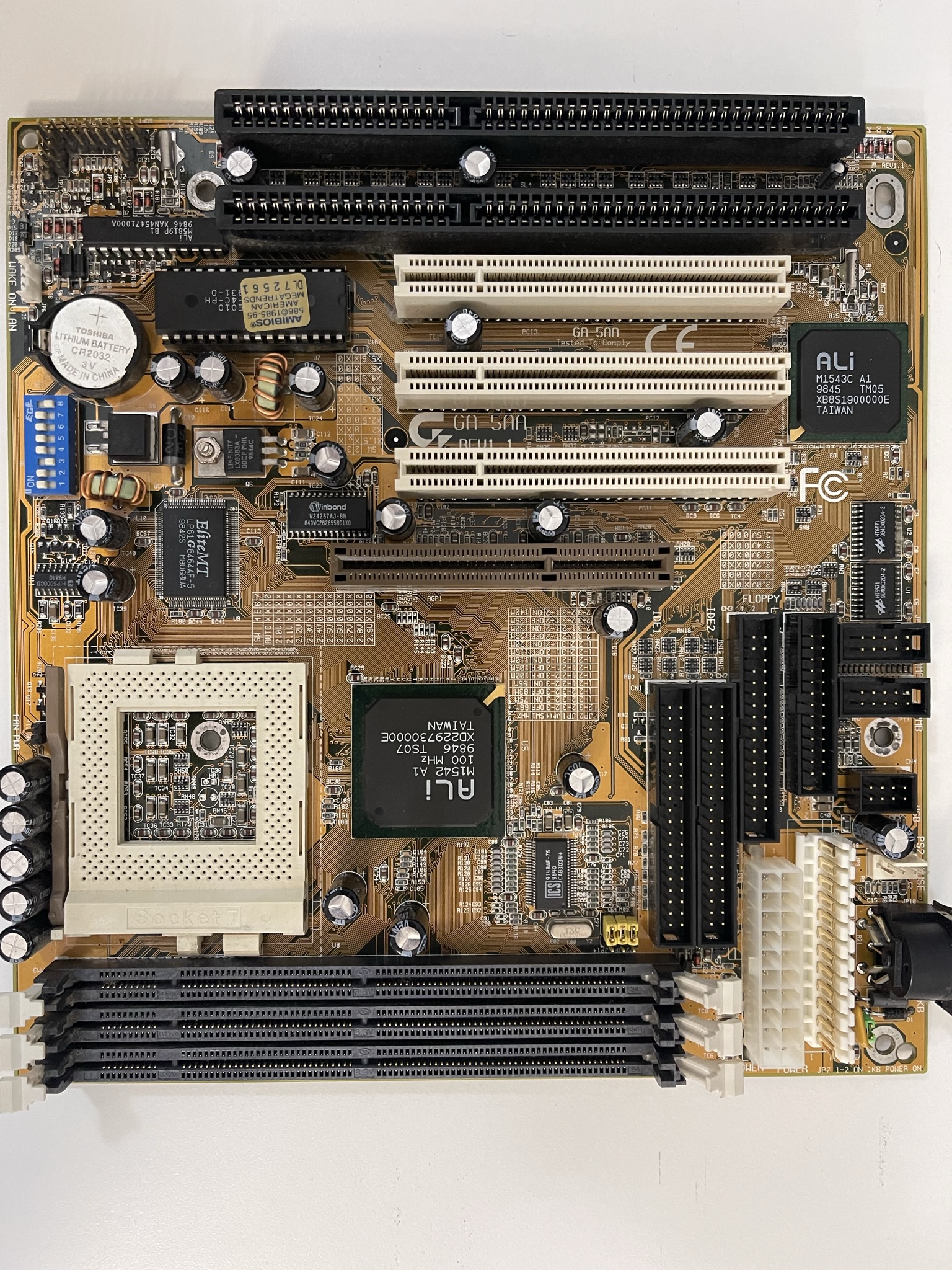

Reply 72 of 80, by mwdmeyer
Yep, I'm just away at the moment but will in a week or so. I have 2, one v3.2 and one v1.1, only tested v3.2 so far.

Reply 74 of 80, by mwdmeyer
Here is a photo of the Rev 1.1 board. My 3.2 is in a machine at the moment. I will try and swap out soon and compare.
https://www.vogonswiki.com/images/b/b3/Gigaby … AA_rev_1.1.jpeg
Reply 75 of 80, by bloodem
mwdmeyer wrote on 2022-03-11, 04:24:
Nice! As expected, Rev 1.1 has the older "E" North Bridge revision. Obviously, it also has the external tag RAM, so it can only cache up to 128 MB of RAM (which, IMO, is perfectly fine for SS7).
