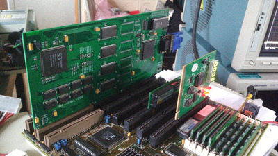

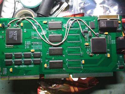

I have think: I make now himself a VLB-Videocard with S3 968 Chip, since i did found datasheet of 86C964 (968 datasheet also, but no pinout , 964 and 968 is eletric same): https://datasheet4u.com/search.php?sWord=86C964
Reference is a german made video card : SPEA Mercury P64V, which SPEA didn't make VLB-variant of him.
Working on pcb design take three week (thanks corona , i have much more time)
First picture of selfmade 968VL-card.
The attachment IMG-20200504-WA0027.jpeg is no longer available
First life
The attachment 968firstlife.jpg is no longer available
But it is instable, massive pixel fail after short run time. Card run at this time only in textmode/VGA , not more test.
Find of cause of fail is fast: clock-line is very long (over 20cm ) and i put resistor as terminator -> run stable in textmode.
Next step: Check of high resolution -> freeze.

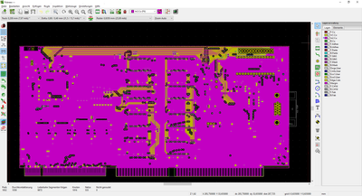

Cause-find is also fast, because i did make a notice: i have swapped inner layer of PCB by my mistake with kiCad (PCB Layout). (1-3-2-4 Layer )
Result: clock-line is not shield by mass-area from DAC-control & data line at top edge from card. I replace memory clock line with coax-cable -> no freeze anymore and stable runs.

Next problem: non stable picture, if windows use hardware-cursor.
Line flicker, while hardware cursor change from arrow to hourglass and back.
Reason is also mistake with inner layer of PCB, replace video clock line with coax cable.

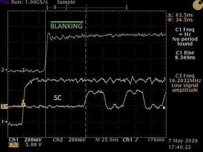

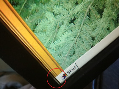

Next (hard find ) fail: Pictures is shifted.
The attachment IMG-20200512-WA0003.jpg is no longer available
But this fail occurs only by VRAM mode and shift-result is depent of color depth. 256 color = 8 pixel shift, 16bit color = 4 pixel shift, 24bit = 3 pixel shift & wrong color, 32bit = 2 pixel shift.
Short explanation: VRAM Card from S3 run in text/VGA mode as convontial DRAM video card. It means: GPU take Data from VRAM and put it to DAC.
VRAM -mode: DAC got Data from VRAM and S3-GPU control clock to VRAM. This is why, S3 Vision968 is not superior in DOS-game/ textmode, their strenght is acceleration in high resolution mode.
Measure on VRAM-clock ( yellow wave = SC = shift clock = VRAM data-out clock )
Attention: SC clock is not same as dot clock. If 8bit color depth is using = 8x lower shift clock rate, because VRAM bus to DAC is 64bit width (64bit bus /8bit color = 8x clock divider ) Here runs SC with ~ 16,2 Mhz , dot-clock = ~ 130 Mhz (1280x1024 @ 72Hz, 8bit color )
It should starting at same time with blanking signal. But there didn't works correct, blanking came one clock pulse too early. (or clock pulse came to late..)
The attachment SID Takt fail.jpg is no longer available
I found after few time cause for fail: I have drawing correct schematic from SPEA video card, but i haven't taken care by drawing schematic in kiCad *argh#+!"$*
Swapping of 74F74-input (Flipflop for delaying of blanking-signal) solves this problem.

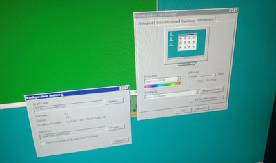

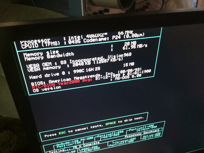

Few screenshot
The attachment IMG-20200517-WA0007.jpeg is no longer available
The attachment IMG-20200504-WA0024.jpg is no longer available
But card has yet only 2 MB VRAM, because: GPU , VRAM and DAC came from broken ELSA Winner2000AVI with 2MB VRAM.
I have buying 4 VRAM later and place it now on 968VL card.

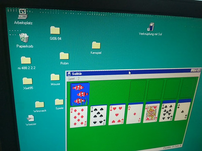

A short video with solitar card jump , windows 95 solitare use mass bitBLT-function of S3 GUI accelerator.
https://youtu.be/RWqGmWDLkV4

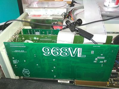

After fixing of fail and mistake on first pcb , i am sitting again on kicad and make second version of PCB. Now it is final and free of fail...wait... i have forgotten check DDC Interface on first PCB....oh...there is also fail.. I make decision: i foregone DDC (= I²C ) Interface and keep one solder joint for IC empty .
A logo on bottom of PCB is neccesary, a "german" #9 *lol* #9 like put big logo on their video card.
The attachment IMG_20200616_185454.jpg is no longer available
Comparsion of first and second 968VL card
The attachment IMG-20200616-WA0010.jpeg is no longer available
Data of 968VL from my design.
S3 Vision 968 GPU
2 or 4 MB VRAM ( EDO or FPM), TMS55160 or TMS55161
TVP3026 DAC (175 or 220 MHz )
and the most important data: VLB Interface.
ROM came from SPEA Mercury P64V, highest memory clock: 66Mhz, much higher than Diamond Stealth 64VRAM Video (55Mhz ?) Diamond ROM doesn't run well, because PLL-line is swapped and i have here a PCI- Diamond Stealth 64VRAM Video, it is honestly a bad designed card.
Diamond Multimedia keep TTL input open, DDC Interface nonfunctional, this is why, i choose SPEA for reference.
But someone would make notice, my card look like Diamond Stealth 64VRAM video VLB. Yes, but my reason was only: easy access to EPROM for update/change without pull of cards.

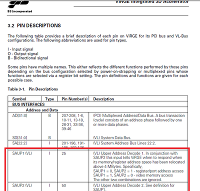

Reply 16 of 66, by mkarcher
Interesting topic. I also thought about modding a Trio64/VLB card into a Virge/VLB card, which would be cool. I confused some things in the first run, but I got some of the stuff straight now:
  • The Trio64 features "glueless VLB support". Glueless means that you can directly connect all relevant VLB pins to the Trio64 chip. The full glueless interface reuses some of the memory data pins for high address bits, so you only have a 32-bit memory interface in this mode. You can reconfigure the chip to only use 28 instead of 32 address lines (e.g. with external pre-decode) by setting CR68.7, so you (possibly) need some glue logic, but you can get full 64 bits on the memory interface. The VAFC (VESA Advanced Feature Connector) also shares pins with 64-bit memory, so you only can have one of these features at the same time.
  • The Trio64V+ has two operation modes: A Trio64 compatible mode (which shares all features and limitations with the Trio64), and a native Trio64V+ mode, called the LPB mode. In its native mode, it supports the "Local Peripheral Bus" (LPB), which seems to be the foundation for the Scenic Highway MPEG decoder interface. In LPB mode, the VL interface is no longer glueless, yet you lose 4MB memory support in native/VL mode. In LPB/VL, you only have address bits up to A22 (addressability of 8MB), and you need an external decoder for the high address bit. You can no longer weasel around it by just supporting a 256MB address space (which you can in compatible mode). In LPB/VL mode, you get an 8-bit VAFC (full VAFC is 16 bits) or Scenic Highway (seems to be always 8 bits) interface and always 64 bit RAM, but no second bank, which limits memory to 2 Megabytes. The LPB modes "Video 16 in" and "Video 8 in/out" are not supported in conjunction with VL. (Also, as the Trio64 does not have LPB support, it also doesn't support these modes).
  • The Virge is "pin-compatible to the Trio64V+" (quote from the data sheet), but I can't find any reference to the Trio64-compatible mode in the Virge datasheet. It most likely is only compatible to the Trio64V+ in LPB mode.
I could find Trio64 VLB cards on the internet, but it seems they are running the Trio64 in glueless VLB/32 bit RAM mode. I did not find Trio64V+ VLB cards (which most likely would be a Trio64 card with the chip replaced and running in compatible mode). This means I have very low hopes of finding a ready-made VLB card that can accept the Virge chip, we seem to need a design from scratch.

Hello
Yes, this is why, i make thougt about new project with Virge/Trio64V+ VLB. Not now, soon must bad windows 10 replaced ! I move slow to linux... 🙄
I would make a minimal Trio64V+/ViRGe design and Lattice CPLD as decoder for SAUP-input. We can config decoder. Without VAFC, without LPB-bus and 2 MB Memory.
Why not 4 MB video memory for card with VL-interface: SAUP2 is need for VL interface and there is OE1/RAS1 by PCI-mode. RAS1/OE1 is memory control line (upper 2 MB range)
ViRGe 325 can't replace Trio64 direct. Only Trio64V+ in LPB -mode can be replaced by ViRGe 325, as you said.
I must check: could Trio64VL ROM run into Trio64 PCI card and back? If yes -> way is free. I have few Trio64 video card from V7/SPEA, with both interface.
Glue-logic on VL-interface is reason for my doubt.
I have here a Trio64 VLB (Spea Mirage P64/VL , Board: P100 Version: V10 ) ) card, it has full 64bit memory bus.
VL interface of my Trio64 VL use a 74F27 as decoder for assert of SAUP-input , but not all upper address line would be decoding. (A27 and A29 contact missed) But i haven't make a note, which adress range will being asserted. It is one of fastest VLB video card for dos gaming (same as Trio32 ).
Ah , a side notice: I have soldered more 968VL card and one runs into VGA/text-mode without problem. pixel fail occurs , if it runs in VRAM mode.
Reason: two memory data line on S3 968 GPU is bridged (solder), both line is upper 32bit memory interface, which upper 32bit memory interface is not using in text/VGA mode.
It explains: no performance difference between Trio64 and 32 in text/VGA mode.
