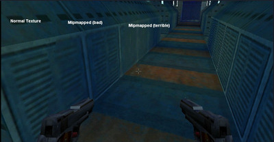

Is a way to disable mipmapping in the latest D3D driver? I don't think this feature ever worked properly on the rage pro.

Reply 62 of 67, by marxveix
Spark wrote on 2023-08-19, 22:56:
Some games have options to disable or change mipmap settings and it has some, but i have not played Shogo or used these settings myself.
more info and commands here: https://redriothog.tripod.com/console.htm
press the"~" while in a Shogo game and type
LodBias <value>
Sets the mipmap range, so you can push those mipmapping lines back.
Default value is 0.7. The lower you go, the further the lines are.
MipMapOffset <0,3>
Offset the mipmap level that it uses by a certain amount. This helps on crappy
cards with very little texture memory.
GroupOffset0 through GroupOffset9 <0,3>
Offset the mipmaps used for textures in each group (this offset is in addition
to the offset applied with the 'global' mipmap offset in MipmapOffset).
Reply 63 of 67, by Spark
Thanks for checking, I did see that page and tried to set those options in a few different ways but nothing worked. Decided to play that game on a different card with working mipmapping instead.
