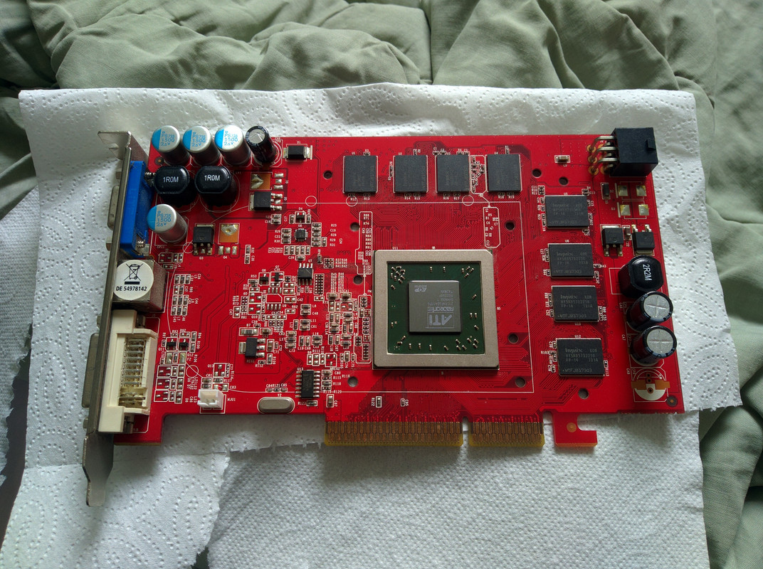

Hi there, got this problem for a while with my Radeon x850xt agp, picture of the card (and caps, that look fine visually)
On cold boot, gpu displays artifacts. BUT if I move the card up or down and reboot after a few minutes they go away and stay away until next cold boot.
Video how it looks in practice
https://youtu.be/WjLsBoNknOo

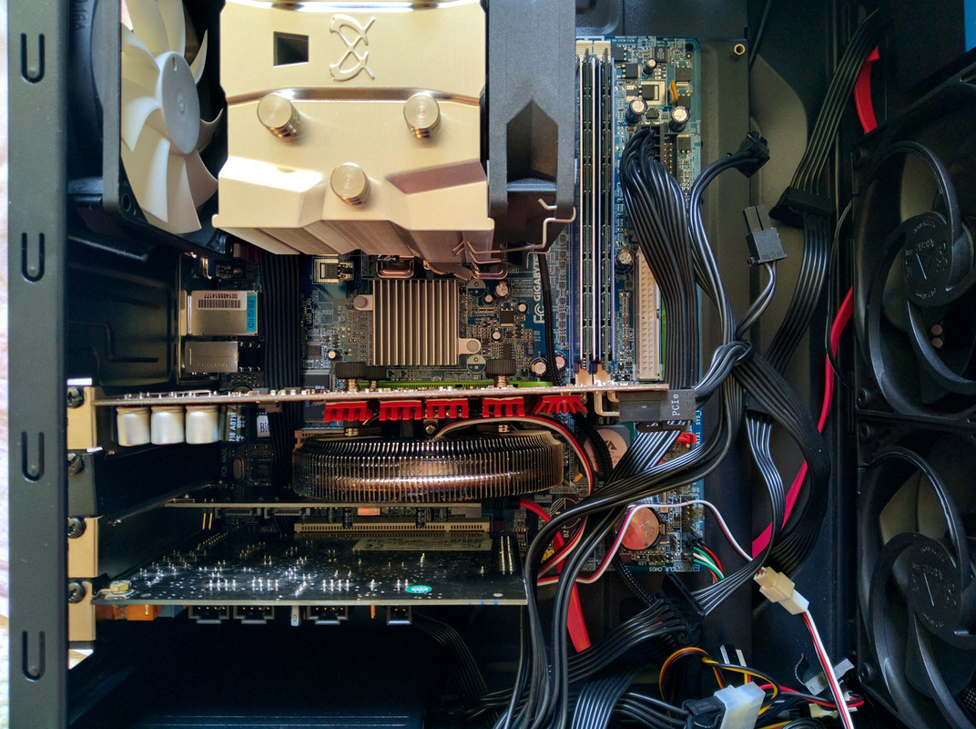

Ziptied the power cable so its always forcing it a bit up, so I dont have to move it, just restart after a few minutes of running. And no artifacts for the rest of the day....
At first I thought it has to be the agp port, since when it works it works for a full day of gaming, but tried the card today in another pc and it has the same problem.
Anyone have any idea whats going on and where do I start looking?

Looks like dying video RAM to me, I guess it could be dry solder joints on the BGA chips that after warming up make enough contact to make the artifacts go away.
I've got a Quadro FX 3000 that exhibits similar behaviour.
If you press on the RAM chips one by one when the artifacts show up, do they change/get better/disappear?

It is like that, but any small movement of the pcb has an effect on artifacts. Will try tomorrow pressing one by one without moving the pcb.
There are times when no artifacts show even on cold boot, but they appear later, if the pcb isnt forced up a bit.

It definitely sounds like there's a bad solder joint. When you flex the pcb you temporarily fixing the connection. Most likely it's one of the solder balls under a ram chip or the GPU is cracked or damaged
Reply 4 of 17, by Dolenc
Ill make a recording today how it behaves when Im gently toching her hotspots.
Tried a bit in the morning, and nothing happened pressing the ram chips or cpu, but bending the pcb worked like a charm.
Agree that its definitely probably a bad solder joint, now the question is just where 😀.
Reply 5 of 17, by Dolenc
Last video record... Pressed all ram chips one by one and core. Nothing really responds, but bending pcb always works.
https://www.youtube.com/watch?v=V93Mnl_82Cg
Im waiting for my liquid flux to arrive, for another project, just dont want to heat everything up, fucking up even that, what isnt broken right now 🙁

Is there a particular part of the PCB that responds to flexing? It's still likely to be a dry solder joint somewhere in the vicinity of the flex!
Reply 7 of 17, by Dolenc
Pressing up near the pcie power inlet works best, but pressing up mostly everywhere works.
Pressing down makes things worse.
Not a bad idea, I will try to zone presses a bit more precise and see if theres a sweetspot.

Oven baking is a largely pointless exercise. Lead-free solder will have a higher melting point than you think, so all you are really doing is thermally expanding and contracting the substrates and parts.
It "might" be worth getting someone to reflow the GPU and BGA RAM chips using a proper hot-air SMD rework station and some good flux, but there's definitely the possibility for it to get a lot worse.

Yea no oven, besides hard to check the temperature its also hard to soak everything in flux, that clears any oxidation on the joints. This is the main problem why it usually fails again after a while.
Im waiting for my flux to arrive, for another r9800 card that is mostly dead, then Ill see what Ill do with this one, prob try to reflow just the memory first and see what that does. It does still work now, even if I have to pre-heat it 😁
If I manage to fix anything Ill update the topic ofc.
Dont know about lead-free, should be, since they started with that in 9x00 generation, but 256bit it is, card runs fine, just the right spec for 1080p and around 2000 era games.

Just an update, that wont help anyone 😁
I tightened the cpu cooler screws, they were really loose, cus I didnt want any pcb bend. Now they are as snug as they go.
And imagine that, no more artifacts. Not when cold, not if I move the card, no ziptie needed....
Been like that for a few days now, so I guess its "fixed".
