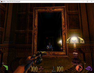

There is a minor problem with nGlide for Undying. -- the mirror does not have reflection. On the 1st level after meeting with Jeremiah you can go into a room, staring at the mirror and the ghost show up in the mirror, sending a cold shiver down one's neck. 😉 So far, only dgVoodoo2 Glide renders mirror reflection correctly, the rest don't. You can check out Direct3D render, since WineD3D also renders the mirror reflection correctly on QEMU VMs. This is an early fantastic experience for horror-themed game. You would miss it if you had played with nGlide.

Are rearview mirrors working in driving games? NFS series etc
I've never played this game; can you clarify? You said no reflection then posted a screenshot with a reflection. Is this the way it's supposed to look or is it wrong? Do you mean that there is no reflection of the GHOST you mention later?

The screenshot showed the correct rendering from dgVoodoo2 Glide or WineD3D from QEMU VMs. 😉 I could also post the screenshot with the GHOST if you would like to see that. 😁 The message is one would be missing some aspects of horror game experience if the game was played with nGlide due to missing mirror reflection.
