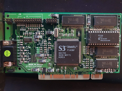

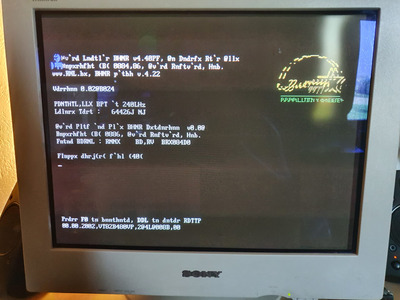

I have this Elsa Winner 1000 PCI card that produces these interesting text corruption and problems as soon as it starts. Computer doesn't complain, no beep at all. Computer is fine with other PCI gfx cards, so the problem is with this card.
I have dumped the BIOS and compared it a known good version found online - identical.
258.57 KiB
1171 views
What do you guys make of it? I am in no way a hardware expert, I've visually checked it carefully though and it seems in pretty good and clean condition and don't see anything obvious.
Is this a case where baking it at 200°C for 10 minutes as I've read in some places would be worth a try to "refresh" solder joints, even if they don't look bad to me?
I've read a heatgun would be preferred in some cases, I do have a basic heatgun and no idea how hot it gets, what would be the proper way for me to do that?
Obviously these cards are pretty available and inexpensive (still very good, highly compatible DOS cards!) so I could really just drop it in the bin. But if I can salvage a bit of retro history and learn something new along the way, I'm definitely game! And in that case no pressure of ruining something of high value 😁
I'm attaching a picture of the card here and can provide more/better pictures of the back or other areas on request, if that can help, cheers!

Reply 2 of 34, by retardware
Looks like video RAM bit errors. Sometimes caused by insufficient decoupling, sometimes by bad mobo or PSU, sometimes by some actual defects.
Edit: Try it in other computers. I have two otherwise very reliable Trio64v2 cards that show such errors in bad computers.

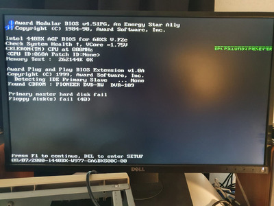

1. on a Gigabyte 440BX mobo - funnily letters are fine there, but the BIOS display on boot is all corrupted (too quick to capture) and there is still corruption on the EPA logo, on the award logo top-left, and the whole left side.

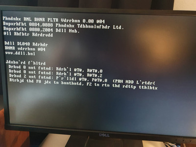

2. on a DELL P4 mobo - looks very much like the same kind of corruptions as the Socket 7 mobo pictures in my first message.

Reply 4 of 34, by retardware
The display on the Dell mobo - I love it, it looks so Welsh 😀

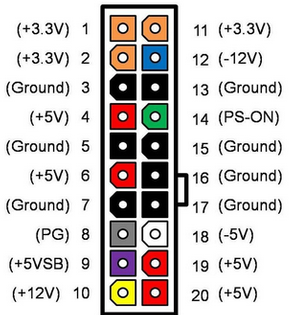

I never did that before, should I measure voltage between any red +5V pin and any black ground pin?
Reply 6 of 34, by retardware
Yes, measure black-red (+5) and black-yellow (+12).
It is always useful to check +12V too.
Because, if it is really high, then it indicates that the loading ratio is out of balance for the particular PSU (too much load on +5, too little on +12V).

Reply 12 of 34, by Madao
Pleas press on DRAM (two below EPROM) and power it -> did change it ?
If no -> next step: Press on QFP IC (S3 Chip). Did change it `?
It is 100% DRAM Problem , causes damage DRAM or bad solder joint or bent lead. (Your card has many scratch, i wouldn't wondered, if PCB trace is cutted by scratch. )
regards
matt

Reply 19 of 34, by canthearu
Yep, you need to reflow the solder joint of the memory module that you pressed which made the display ok.
Baking the card won't do that, it will just cook it (which is not what you want to do)
A good soldering iron, flux and maybe a touch of solder will fix that memory module right up in a fraction of the time you would spend you would spend baking it. And would actually fix it, rather than just cook it (seriously, it isn't dinner, it doesn't belong in an oven!)
