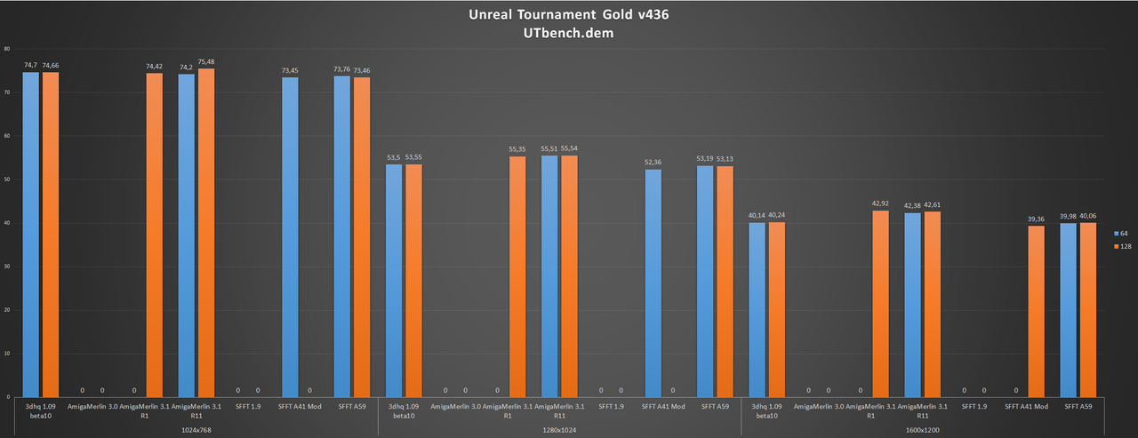

Unreal Tournament Gold v436
Glide
Bench, UTbench.dem... A bit more realistic for this game, than flyby.

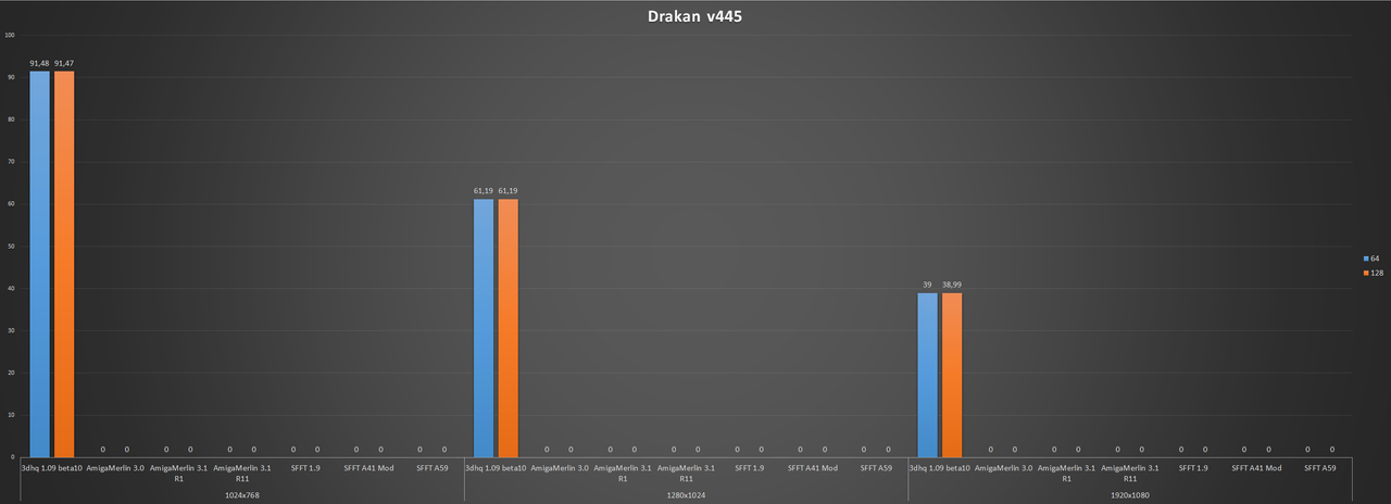

Drakan v445
Direct3D
Bench, builtin +fpstest

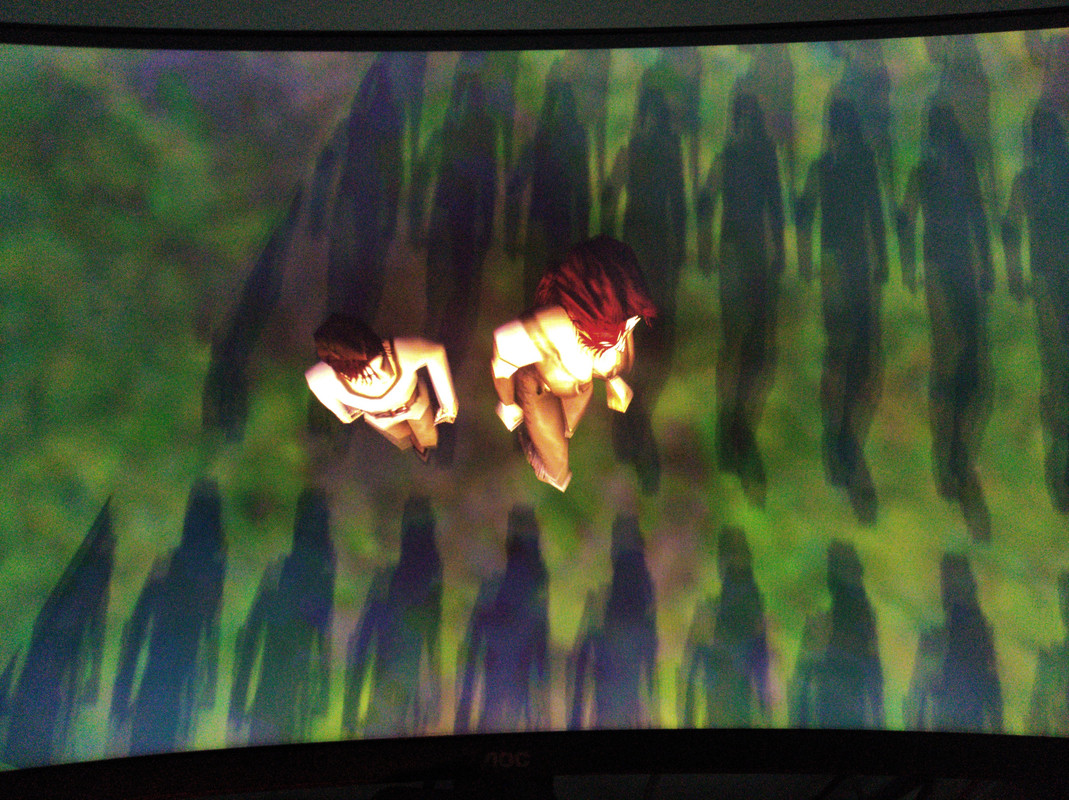

D3d - Drakan showed some shadow problems as can be seen bellow.
Mikepedo 1.1
Drakan shadow problems. Opengl didnt look that promising, removed from test.

1.07 had drakan shadows problem, 1.08.04 worked fine, but OpenGl was kinda slow Q3 gave 40fps, while others were around 68fps. You can see where it slows down, maybe theres some aa stuff that isnt fullscreen going on, or force 32bit on certain stuff...

Drakan

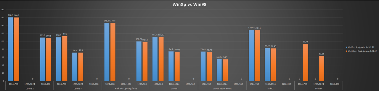

So conclusion time. You cant really go wrong with official 3dfx drivers, atleast for games in this era.
But getting a few more frames in openGl games and more costumization options is always welcome.
Me personally, Ill use Raziel 1...16, and replace the d3d.dll(3dfx32vs.dll, 3dfx16vs.drv) with the ones from AmigaMerlin.
Fully (I guess) working driver, with some perf benefit and working glide in 128mb mode.
UPDATE after a few months. This RazielAm29 combo works fine, good performance. Finished blood2, mdk(1) and drakan, also tested a bunch of other games. 128MB has some texture corruption in sw: roque squadron when using glide, mdk2 demo, when you get to play the doctor he is black. And I dont mean it in a racial way, he is just all black, could be resolved in full version of the game, havent played it yet(also didnt try 64mb). Thats about it, older stuff, some newer, it just works as expected. Well recommended.

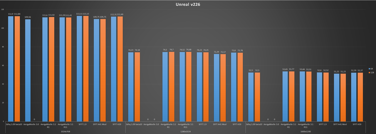

First lets cover 64vs128. Basicly same situation as before. Margin of error stuff for this 7 games. AM r1 and r11 and sfft a59 showed a 1fps improvement in q3. And q3 is a really repeatable test and usually has no error.
Two amigas R are also the only drivers that have no artifacts running 128mb in unreal(s).
Also, unrealated (get it?), I added 1600x1200 cus I noticed in win98 that it works just fine on the current monitor. And every card, if it has artifacts in glide, using 128mb, it doesnt have them at this resolution!

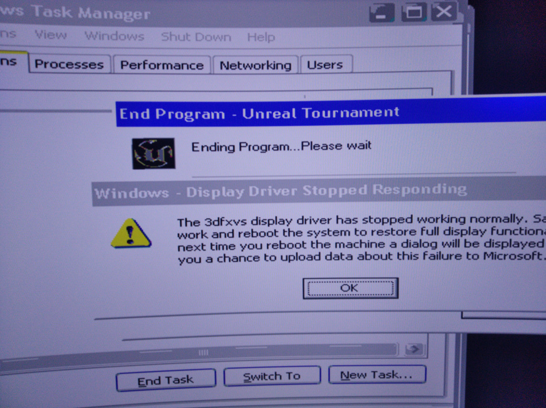

3dhq 1.09 beta10
- Install procedure: Run installer, at the end asks if you want to install 3dhq tools (thats just v.control)
This driver feels like theirs from win98. Q2 still doesnt work, the rest does, performance is good - great. But I had lots of freezes with it. Not crashes, but freezes in game, all the games 😁.

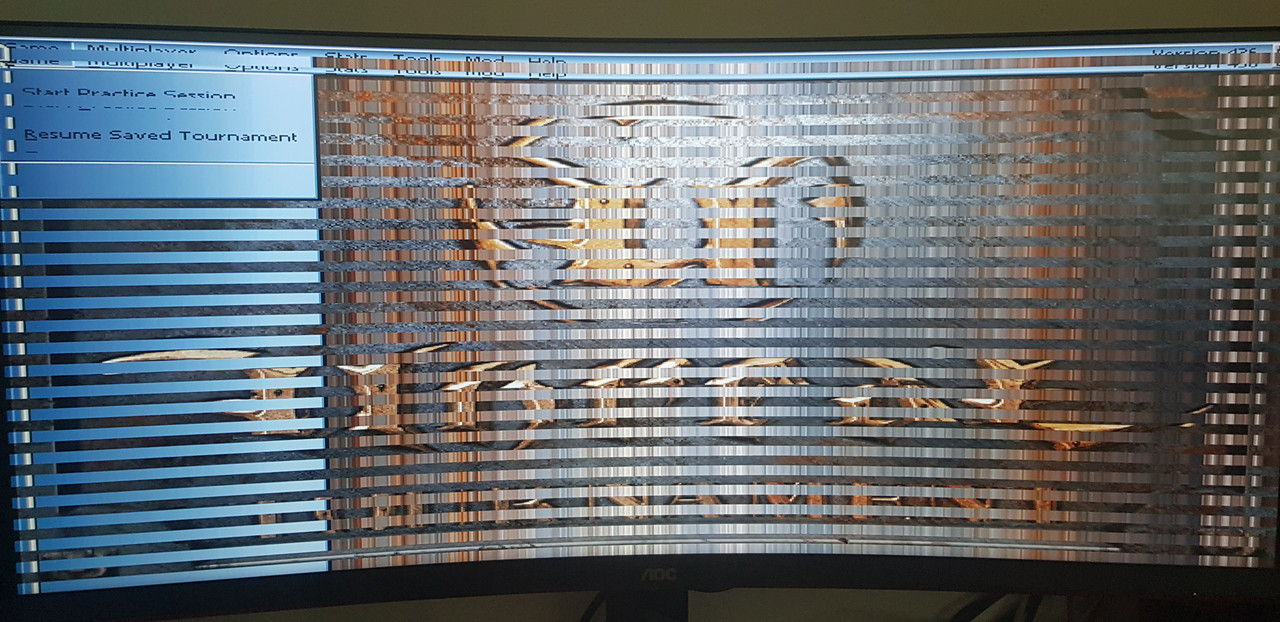

Oh right, got this puppy starting unreal tournament, think I changed the resolution and it went away.
Barely finished the benchmarks, but got everything. Also the only one that I can actually show Drakan numbers.
But because all of the freezes (and it really is random, HL, three runs no problem, lets do one more, freeze..) I dont recommend it.

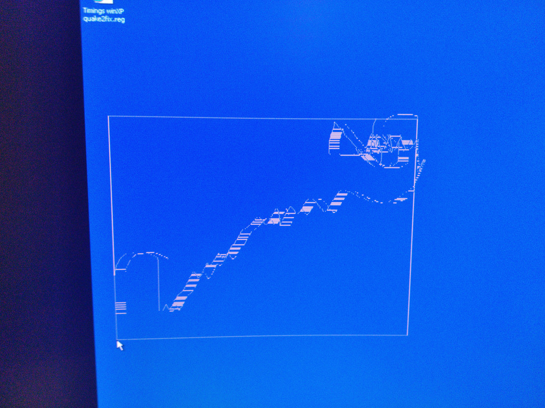

SFFT 1.9
- Install procedure: Run setup.exe, reboot, after install controll center of your choosing, none comes with the driver
q2 low performance, at first I thought vsync was on, disabled it in 3 ways, enabled it, some change, but nothing worth mentioning. Also if I start and end the bench, gives 67fps, thats not exacly vsync limited on a 60hz.
At 1600x1200 got pink lines showing.
Half-life, openGl mode is not supported, couldnt run the game.

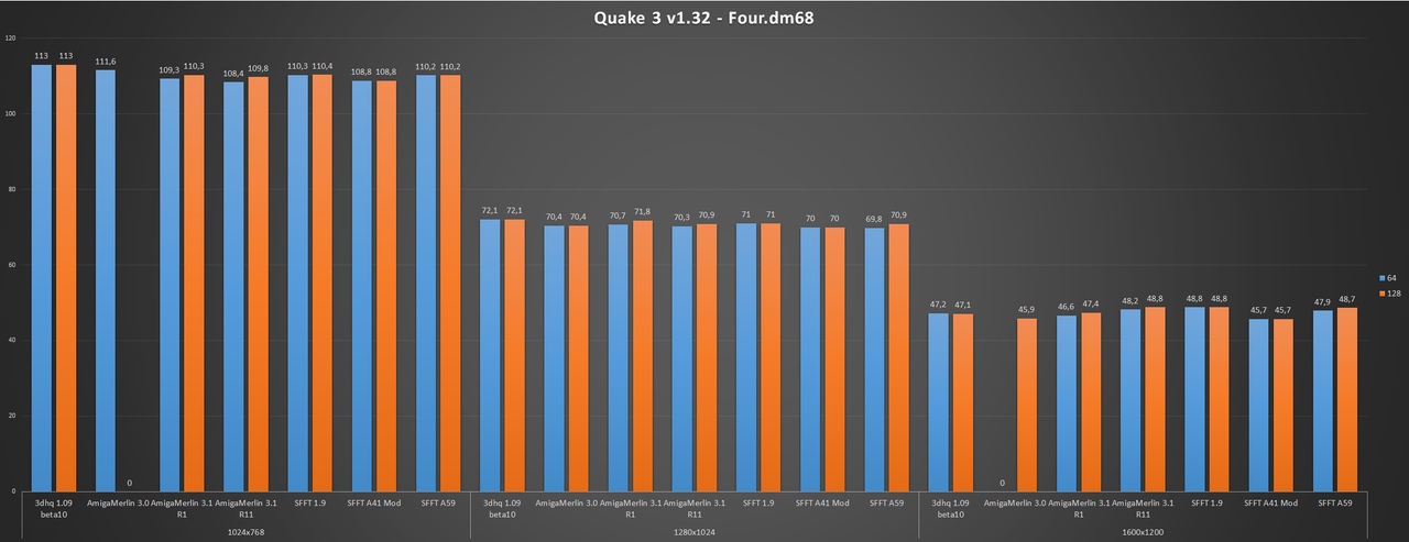

q3 got pink lines on 1600x1200, but they went away after I changed resolution and then went back to 1600x1200.
Unreal worked, but then crashed the driver when I closed the game.
Ut freeze in menu.

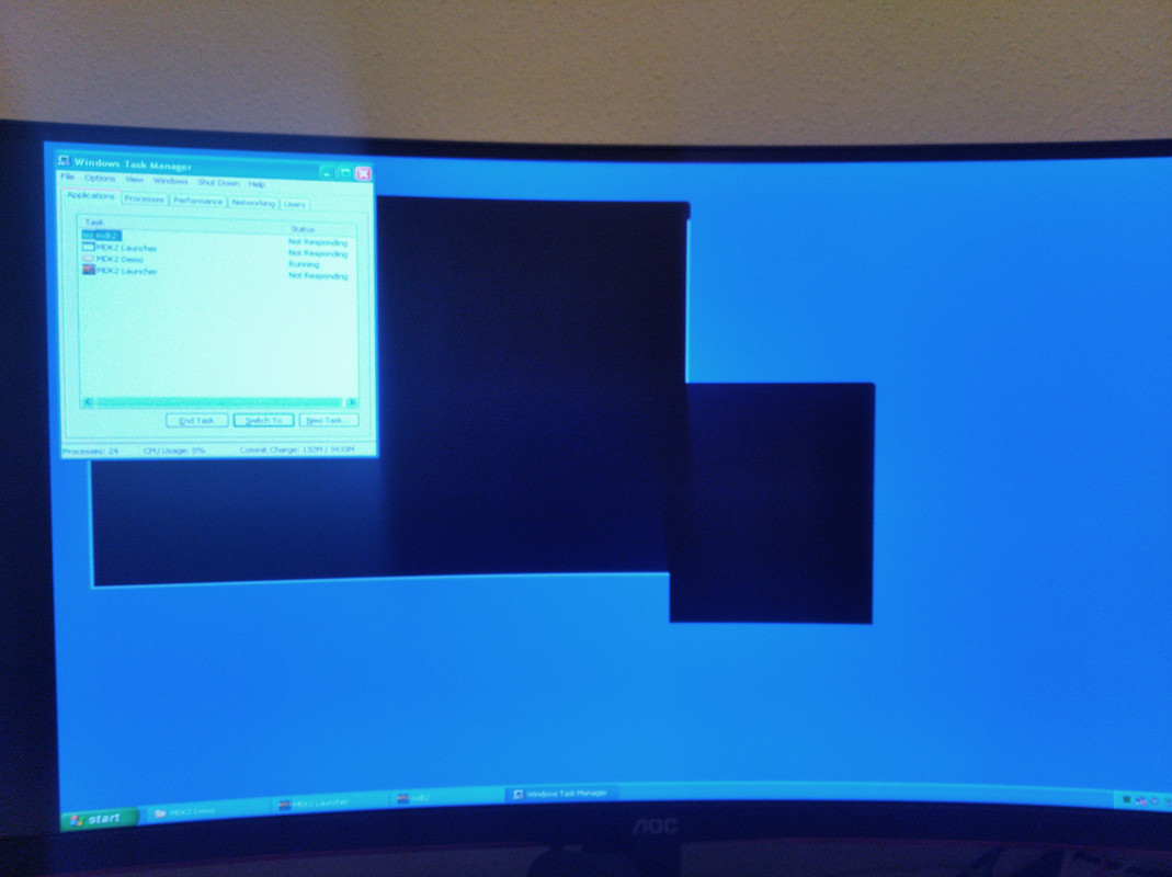

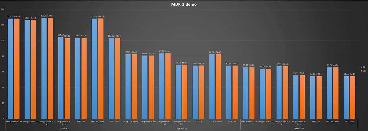

Mdk2 on first run crash, then it works. This goes for all drivers, except forgot which one, will write it down there.

HL works, but random freezes, Unreal driver crash on exit, UT freezes sometimes ingame, Drakan black screen on launch, mdk2 had one freeze.
Out of 3 sfft drivers tested, this is the one I would prob pick.

q2 normal perf, but freezed on 3rd run. q3 also freezed a couple of times.

q2 works! Also no pink lines in 1600x1200, did crash once, but just once. HL worked, could freeze. UT freeze in menu when changing resolutions, game works, had a long session, just dont go in the menu 😁.
No artifacts for 128mb in glide. Drakan worked but froze, also had sli lines and shadow problems (long time no see!)

q2, slow, 1600x1200 pink lines, also got this when I exited, could paint something with holding the mouse button. I forgot, but think I got this also in one sfft driver once.
HL black screen when starting the game, Drakan freeze mid benchmark.

Unreal
Unreal tournament
Drakan

So conclusion time.
Is there the obvious pick for WindowsXP? No.
OpenGl problems can be sorted(if present) with the use of WickedGl or MesaFx. Not sure how would I approach Drakan, tried "Enable auto mipmaps" that I found for lots of d3d games, but no change.
I was most dissapointed with Unreal tournament having problems. I mean if you gonna have one game working perfectly, its this one.
I would go for Amigamerlin 3.1 R1 and then troubleshoot on the fly. This one won me over with no 128MB artifacts, and q2 not having that slow fps issue. Out of sfft I would go for alpha41 mod. Not sure what to do for older d3d games if they have problems like Drakan did.
OS Comparison
I will just squize this into this post.
Performance, well, when I saw the chart, I was quite surprised being this even. Expected win98 would be faster in most, if not all cases. But its the opposite, yes margin of error. But it is what it is!
But, win98 proved to just work. While XP has a whole shitton of problems with the video driver. If it works for you and the games you play, good for you. No arguing that XP is the better os. I will mostly stick to 98.
