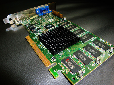

I would look for a Voodoo3 2000 AGP. ?Should? be not so expensive than the bigger 3000/3500 brothers. I had a V3 2000 AGP in 1999 and flashed the 3000 Bios without any problems, although my card only had 7 ns RAM, sepcified for the stock 143MHz. 166 MHz should be possible with every 2000 card (with a fan on the small heatsink!). Maybe you could find one with faster 6ns (166MHz) memory chips.
Here for a example a V3 2000 AGP from my 3dfx collection. The access time of the memory chip is circled in red. This is how you can recognize 7ns memory chips on the card and all the other brands on the market.

Lol, not entirely the topic here, but I just realized for the first time that this forum allows photo attachments of a luscious 5 megapixel. Would not have guessed, most do about 1600 x 1200.
Guess I may set potato to stun some time when it counts.
Edit: Or so my browser claims, erroneously. Actually, it's 1920 x 1440 or 2.8 MP.
But, still more than I cared to produce with Mr. Potatoman lately.

I have scaled down the picture size and compression rate (from 1,5MB to 750 kb file size) for people with slower internet connection.
Ah, ok, then my browser isn't nuts, after all.
Nice to see that there's one person out there who still cares that not just anybody has a gigabit dsl connection these days. 😉
In my conservative understanding, 5 MP is already pushing the optical qualities of pocket cameras, under good conditions. So with most cellphone lenses, anything beyond 3 is probably just cockalorum by numbers.
