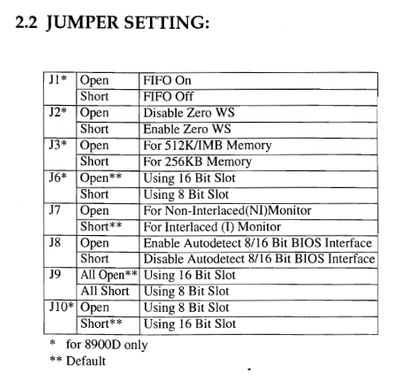

I recommend to check the jumper settings, I have the manual so here they are (* is the default setting for each, you may try those first).
First the 3 jumpers at the top, it should work regardless of the setting:
J1: Enable second stage zero-wait state (open) / *Disable second stage zero-wait state (closed)
J7: Non-interlaced display (open) / *Interlaced display (closed)
J8: Autodetect 8-bit or 16-bit BIOS (open) / *8-bit BIOS (closed)
Next, J6 and J10 should be kept open and closed respectively to run on a 16-bit slot, you need to add 3 unpopulated jumpers to run on an 8-bit slot and even then it's kind of pointless since it doesn't run on XT-class machines (internal BIOS probably has 286+ code):
J6: *16-bit ISA (open)
J10: *16-bit ISA (closed)
The 0WS jumper (J2)doesn't seem to work for me, so I keep it open.
Finally keep J3 open unless you have 256KB of video RAM.

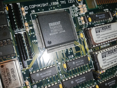

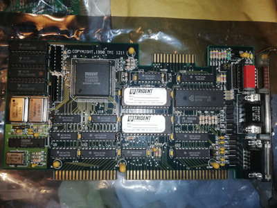

Hi, it's this one. It has two EPROMs. I could dump them if that's helpful.
Not sure if they compatible with the 8900D, though.
Tiido likely knows more aboutthe matter than me.
All I really know is that the 88xx, 89xx, 90xx prefixes are references to the years of each chip's release/creation.
The suffix likely is used for different revisions, RAM types etc.
Reply 9 of 12, by cluster.fsck
Success! Closing J10 was all that was needed. J6 open, J10 open wasn't a valid configuration.
There was an instruction sheet in the box. Should have though to check jumper settings, but my mind went right to the unpopulated ROM. There wasn't a socket originally and it looked pristine, but I just figured the previous owner did a really good job removing it.
Thanks!

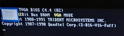

FYI : Two numbers show what mode is enabled for BIOS/ISA bus.
"8" means 8-bit and "16" means 16-bit (more is better)
"Foff" means you aren't using FIFO (enable for higher speed, may present compatibility/stability problems with some MBs)
