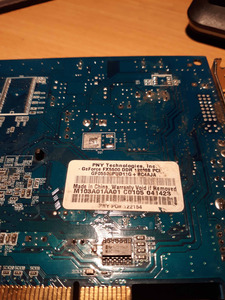

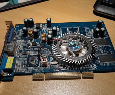

So I've got Nvidia FX5500 PCI 256MB RAM from china and card itself works but not with this mobo, shame and confusing Quadro NVS 280 PCI works. 😁
haker120 wrote on 2022-08-30, 11:46:So I've got Nvidia FX5500 PCI 256MB RAM from china and card itself works but not with this mobo, shame and confusing Quadro NVS 280 PCI works. 😁
The Fx5500 does require a fair amount of voltage from the pci bus, it would likely be perfectly at home on any board that has the supplemental P4 power connector.
Those Chinese knockoff cards are known for not working with older PCI slot only motherboards ( I think it needs 3.3 volt from the PCI). The NVS 280 is basically the same chip, and with such a CPU limited setup it will perform just as well when used with the 45.23 driver and maybe overclocked. I ran 3D Mark 2000 with an NVS280 (64 bit), an FX 5200 256 memory 128 bit card, and a 128 64 bit FX 5500 on my TXP4 with a k6-3+ @ 500, and the results were extremely close.

Repo Man11 wrote on 2022-08-30, 15:02:haker120 wrote on 2022-08-30, 11:46:So I've got Nvidia FX5500 PCI 256MB RAM from china and card itself works but not with this mobo, shame and confusing Quadro NVS 280 PCI works. 😁
Atheatos detailed how he modified one of these cards for an external source for 3.3 volts since the PCI slot on his Asus P5-A didn't supply it: https://youtu.be/U8W6A-VKroE?t=473
So it's power issue not mobo's by itself? I mean it's still PCI and it'll work as long as enough power delivered to card?
haker120 wrote on 2022-08-30, 17:36:So it's power issue not mobo's by itself? I mean it's still PCI and it'll work as long as enough power delivered to card?
The card is built expecting the slot to have 3.3 volts - if the slot does not supply 3.3 volts it will not work. Older PCI FX cards weren't reliant on the PCI slot having 3.3 volts and are more flexible about what motherboards they will work in. I've avoided this issue by sticking with the older FX based PCI video cards for my TXP4. Here's an example of one that has worked for me.
