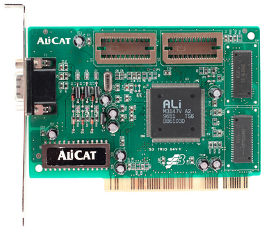

Boredom led me to browsing VGA Museum again. From there I stumbled upon another collector's website: https://vgamuseum.ru. The person behind it has a cool collection of cards, but what intrigued me the most were the ALi cards. I have never, ever heard of them, let alone seen one in the wild. Information is very scarce, but there seem to be two graphics chips used:
- ALi M3145 "ALiCAT" or "ALiCAT I"
- ALi M3147 "ALiCAT III"
Wikipedia only lists those two as being made in a card format. It also says they are "most likely S3 Trio64V+ compatible". But one image of the M3147 card on the aformentioned website proudly displays the S3 logo and "S3 TRIO 64V+" on the card's silkscreen:

Reply 1 of 7, by mkarcher
This would not be the first card that cloned the pinout of the Trio64/V+, although it is a completely different card. There also is the Sigma Designs Inc. REALmagix64/GX with that pinout. Everyone and his dog and their cats already had Trio64/V+ graphics card PCB designs already at hand, so producing a chip with a compatible pinout significantly eased entering the PC graphics card market.
Having S3 printed on the silkscreen doesn't necessarily mean the chip in the card is either made by S3 nor software compatible to any S3 graphics chip.

Reply 4 of 7, by mkarcher
kikipcs wrote on 2022-10-16, 12:31:
Kinda odd that ALi would have the S3 logo printed like that - they must've got some permission from S3 to use it, I guess. If I get one I'd be happy to give it to someone to delid it and see what's about that pin compatibility.
You might be overthinking it. We don't know whether this card is actually produced by ALi, or just a cheap OEM card that uses a graphics chip by ALi. I'd explain the combination of the S3 logo and the ALiCAT logo by the manufacturer of that card just picking their cheap OEM Trio64/V+ design, adding ALiCAT in the top left corner and re-spin PCB production for the ALi graphics cards. In this case, the S3 logo and text would just be an accidental oversight and not something to research for. Take a look at the original ALiCAT II card that has excatly the same PCB, but a slightly different silkscreen at https://wiki.preterhuman.net/images/4/43/Alicatii1.jpg . And to add to the confusion: Someone seems to have mounted a Trio64/V+ on an ALiCAT branded PCB like the one you linked: http://www.vgamuseum.info/images/palcal/s3/28 … ucat_top_hq.jpg .

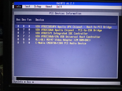

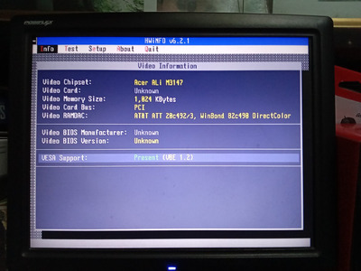

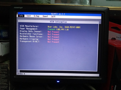

Reply 5 of 7, by b0by007
I have this interesting video card in my retro pc. I dont remember where I got this pc. I remember using it as router 10 years ago. But before that, dont remember.
441.02 KiB
800 views
Alicat m3147
I cant find drivers for it. I tried S3 trio 64v+ drivers, but no luck. Here are some pictures from hwinfo.

Reply 6 of 7, by mkarcher
b0by007 wrote on 2022-11-01, 22:58:
https://www.driverguide.com/driver/detail.php … driverid=150655 seems to contain a Windows 95/98 driver for that card without obvious adware included. Click the file name, not the big green download button. Googling for "ali m3147" reports a lot of hits that can be used as clues to find a driver for other operating systems.
Reply 7 of 7, by b0by007
The drivers worked like a charm.
Now I can enjoy 800x600 at true color (24bit).
