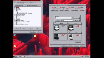

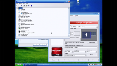

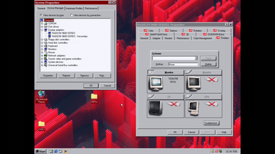

My new-to-me Gefen VGA "Scalar" seems to crop (0verscan) the image if the refresh rate is above 60Hz. Does anyone have any suggestions how to deal with this?
It works well in windows, at 1024x768@60Hz, on multiple PCs (I tested some others, but limit 5 attachments -- all the same result though):

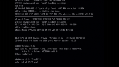

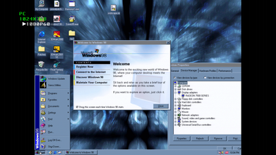

If the refresh rate is above 60Hz, I get varying degrees of overscan, both at 720x400@70Hz and 1024x768@75Hz:

Reply 1 of 4, by darry
3 possibilities
a) If your Gefen product (which specific one ?) has a menu it should allow you to adjust image size and position
b) Click on the button labeled "Monitor" and, depending on driver version (AFAICR) you will have options to adjust screen size and centering . See [1] for example screenshots relating to TV out, VGA monitor options will be similar (AFAICR), but I can find any screenshots .
c) Try PowerStrip
[1]
https://www.anandtech.com/show/389/6
Reply 2 of 4, by rasz_pl
as is the case with Old 386 PC with CRT Tv those types of converters need to sample incoming video data and then format it accordingly it, the easiest way is to hardcode some common timings (resolution/refresh rate) and simply ignore the problem of auto detection
tldr: shit scaler
easiest solution is buying cheap big LCD with VGA input just for retro activities
