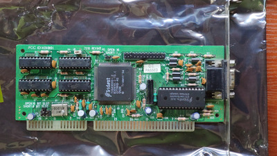

Ive had this graphics card for a while. Only just saw with my poor eyesight that the rom label says faulty! No wonder i had all that trouble yrs ago.
Anyway I justgot a tl866II plus programmer and was trying to read the rom in the hope of writing a fresh version. Or getting a new rom installed.
I keep getting an device id error. Im not sure what to select in the software. As there is no TMS option.
Are the any replacements i could get fairlyeasy and program.
Many thanks for any help.
You can uncheck the "Check ID" checkbox in the Options group (bottom left part of the Xgpro app) and retry, reading should work the same for any pin-compatible EPROMs, any 27256 chip will do for reading.
As for the replacement options - probably there are too many to tell you the exact one. See the stores you can easily reach, look for EEPROM(flash) chips. Some kind of cheap Winbond W27C257 should work ok.

The "read ID" checkbox must be unchecked!
Also, there's a BIOS file at VGA Museum..
https://www.vgamuseum.info/index.php/cpu/item … ent-tvga9000i-1
Just in case the BIOS in that EPROM is really faulty..
If it's readable for the TL866, I'd try to make a backup of the old BIOS first, of course.

Tridents always have a BIOS where the data is shuffled a bit and when the dump is done with software such as NSSI, you get a dump that will not work on actual hardware when burned on a memory chip.
If I can uncover my TVGA9000-1 I'll do a dump of its ROM that should work.

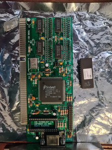

Dumped the Bios from my TVGA9000i-2, not sure if that -1/-2 revision is critical, the version name is the same D4.01E as from file from VGA museum.
Trident 9000i-2 Ver. D4.01E.bin.zip
20.18 KiB
54 downloads

The original BIOS chip has a sticker mentioning "Cirrus Logic" on it. I don't think it's worth to read that chip for getting the Trident card to work. A Trident card will not work with a BIOS meant for a Cirrus Logic card. Sourcing a TVGA9000i dump from the internet (possibly VOGONs) seems like more promising.
