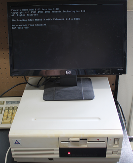

Edit: I've seen this picture at vcfed.org..
It shows that the Leading Edge Model D reports "The Leading Edge Model D with Enhanced Video BIOS".
So maybe there's a video mode for that special mode available, similar to how it is with EGA/VGA BIOS?
