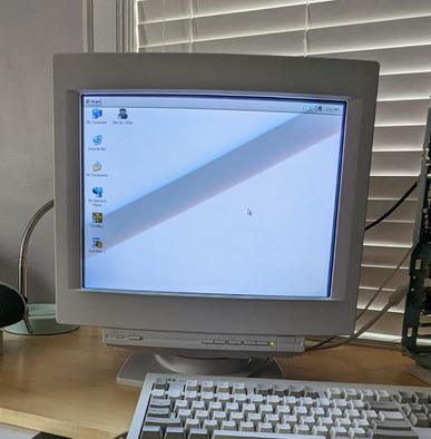

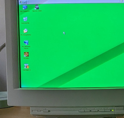

Hi folks, I've got a new old stock Sony Trinitron that has a slightly darker patch of pixels in the bottom left corner. This can be best seen with a green or white background. With the white background it just looks a bit gray. Any idea how I might be able to fix this anomaly? Degaussing has no effect. Thanks!

Thank you for the suggestions. A magnet does help reduce the discoloring but only temporarily (and if aligned the right way). I've looked into adjusting the beam landing but cannot find any directions on how to do so and I cannot find it in the adjustment menu. Is it normally there?

Something has magnetized that corner. It may go away if you do several degausses over time but if not an external degausser may become necessary. Perhaps the mounting bolt has got magnetized and they're generally a bit far from the internal degauss coil and often outside magnetic shielding to get a good effect anyway (that shield can also get magnetized).
If you have a drill or some other rotary tool, you could place a magnet into it and spin it around nearby the affected area. Gentle sweeping motions near the affected area slowly going from far to near to far again.
If there's a speaker near that corner, it can be the source too. Speakers sometimes have unshielded magnets in them and this will affect the image like seen.
Reply 6 of 12, by gamingretro
The model is Sony CPD-2003GT
No speakers; I've actually moved it around the room just to be sure it's not environmental.
I wonder if just placing a magnet under that corner of the monitor would work or if that would cause more damage over time?

No worries, thanks for looking into it. I've been able to tape a thin magnet underneath that left corner, which seems to fix the problem. Hopefully it'll continue to work long term...
