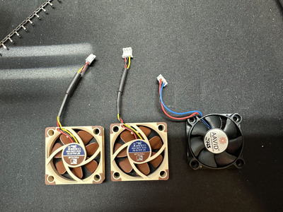

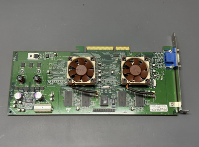

Finally got a hold of a Voodoo 5 but one of the fans was a little noisy (makes sense for something 20+ years old). Can't seem to find any new old stock of the original fans, so figured why not upgrade them instead 😉 Noctua 40mm 5V fans to the rescue!! Picked up some parts off digikey and a little cutting and soldering later have something even better then stock!
Incase anyone is interested these are the parts off Digikey
CONN RCPT HSG 3POS 2.00MM
455-1126-ND
PHR-3
and
CONN SOCKET 28-32AWG CRIMP TIN
455-1318-1-ND
SPH-004T-P0.5S

To be fair I don't think it takes much to be " better then stock" however your mod is very neatly done. long live the V5!

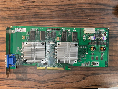

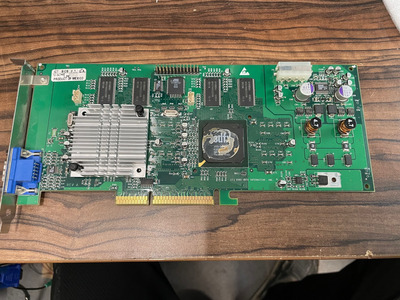

I heated them up using my heat gun then credit card + platic wedge and they went off pretty easily. They are attached with those plastic pins. Originally they have 55mm holes, but I enlarged them to 57 and not they fit perfectly. Card is much much cooler and also completely silent because of those 5v noctuas.

Done this mod myself aswell, these are the heatsinks i used; (you do need to file the mounting points a bit to have them fit properly)
