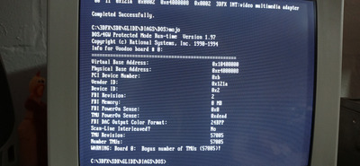

I'm hoping some of the voodoo guru's on here can help me with diagnosing the problem(s) with this voodoo2 card I picked up recently. It has the fairly common symptom of being detected as a PCI multimedia device, but failing the Mojo test. Here are the results of the test:
1.89 MiB
1644 views
The first issue is obviously the FBI memory is 0 mb, and then when it tries to initialise the TMUPowerON sense, it reads 0xdead! That cant be good! The test then detects 57005 TMU's, which obviously isnt right...

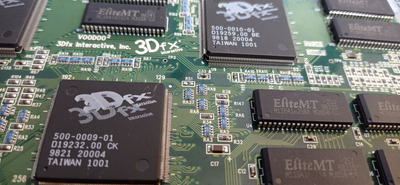

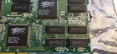

Taking a look at the card, I only notice one problem - it looks like R51 is missing, which I'm sure is causing at least part of the issue:
1.51 MiB
1644 views

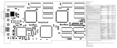

I dont know what brand my card is, but the PCB revision is 600-0027-02-B. Looking at the schematic found here on Vogons for the INNOVISION_MIGHTY_3DII_V3, I see that resistor's value is 10R, but the innovision is revision 600-0027-03. Do you think its safe to use the 10R resistor on my card?:

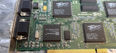

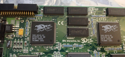

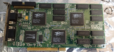

So.. could the missing R51 be responsible for all the issues? I see there are quite a lot of "missing" resistors on the PCB, but it looks like they were never there because the pads are still perfectly clean/unused, whereas R51 looks like there was something soldered on there.. Here are some more pics of the rest of the card:
1.84 MiB
1644 views
464.86 KiB
1644 views

Reply 2 of 15, by Imperious
If the pads are clean likely there was nothing there in the first place. R51 is a 10 ohm 0603 size resistor so replace that first and take it from there.
I'd also check the pins on the TMU's and FBI are not loose. Use a scalpel blade for that.
Good luck.
Reply 3 of 15, by sdz
R51 needs to be present, it's quite important. Actual value is not that critical, 10-22R should be fine, as it's just a series termination resistor.
For a quick test you can replace it with a blob of solder and see if the card works.

I replaced resisitor 51 with the correct part - didnt make any difference to mojo's diagnostic results.. so I poked around a bit more and found 1 resistor on RA9 that was open circuit, so I replaced the array with a suitable replacement and confirmed that all the connections through the array are now good, but again no change to mojo's result.. I have also been browsing this and other forums trying to find if anyone has been able to fix the "0xdead" TMU error I have and it doesnt look hopeful.. all of those threads tend to go quiet with no-one posting a successful repair. So my questions at this point basically are:
Does anyone have an idea where I should look next with diagnosing this card? I was thinking trying to check if the TMU is getting power, but not sure which pin on the TMU is power?
And has anyone done(or know of) a successful repair on a voodoo card with a "0xdead" message? I'm beginning to think that maybe "0xdead" does actually mean the TMU is dead?
Reply 10 of 15, by sdz
TMU power pins are: 15 27 31 43 58 73 78 96 109 116 128 140 143 153 163 173 183 187 203
The RAMDAC should provide a clock to the TMU, you can check TMU pin 186 if you have an oscilloscope. You could also check TMU pin 208, RESET. This should be directly connected to FBI pin 197.
Also, gently poke all the FBI and TMU pins and see if they're actually soldered. This is really important to check, although they may look fine, they can be detached from the PCB.

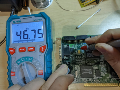

Hi all. So I tried to test the voodoo with a friend's oscilloscope, but I don't really know how to use one.. I did manage to get it to show some signal next to the crystal and also in a few places (like R153,R154,R155). I also thought I spotted a clock signal around pin 186 on TMU 0, but it didn't seem to also be there on TMU 1.. so that is probably the issue. I also noticed this: I saw someone else on vogons testing the capacitance here :
189.85 KiB
1173 views
But on my card it only goes to to 50k or so ohms, but I think this is meant to go up to 300, right?
Reply 15 of 15, by meljor
Capacitors can not be measured in circuit...
