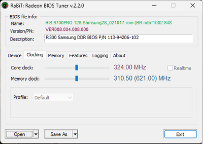

Reply 26 of 37, by swaaye
TheAbandonwareGuy wrote on 2023-03-15, 00:13:
If a cards artifacting at BIOs underclocking the VRAM isn't going to help, as its not even running at full power state until you load drivers anyways.
Does the 9700 have more than one clock state? I don't think it has any power management. I think R420 was the first high-end chip to implement it.

Reply 27 of 37, by TheAbandonwareGuy
swaaye wrote on 2023-03-15, 18:21:
This is possible. I plan to do some more detailed troubleshooting on my AIW 9700 later, I'll see if I can confirm.

Reply 31 of 37, by TheAbandonwareGuy
So I got the R9700 Pro back out, and yes it is a single power level setup.
I tried underclocking, putting a potato chip bag clip on the memory modules to add some pressure to them, etc,
None of it helped. I also noticed when pulling one of those clips off, mannn do those memory chips get hot. No wonder they fail.
Also of note is that atleast mine didn't have thermal paste on it, it had thermal adhesive. That's noteworthy because that could cause different parts of the GPU package to be under different level of tension, making BGA failures that much more likely.
I own too many graphics cards: https://docs.google.com/spreadsheets/d/1qDcUg … of=true&sd=true
