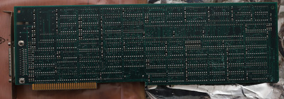

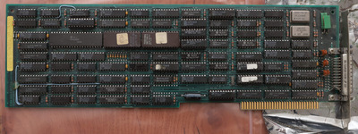

Anybody seen this card before? This seems to be the Olivetti GO423 (Positive Graphics Controller)?
P.G.C. GO423 (Positive Graphics Controller) For M240 - M280 - M290 - M380
https://minuszerodegrees.net/manuals/Olivetti … 20computers.pdf
It can display up to 640x480. But no code in the ROM, seems not to be an EGA card, more related to CGA? Connector is DB25.

EDIT: This seems to be the connector:
https://forum.vcfed.org/index.php?threads/m24 … -adapter.66233/

Predator99 wrote on 2023-03-14, 20:52:
Anybody seen this card before? This seems to be the Olivetti GO423 (Positive Graphics Controller)? […]
Looking at the chips on the card, it's definitely not technologically related to EGA. The EGA card's prime technological property is the video memory built from DRAM, with an internal 32-bit video memory data bus. This card is designed entirely different. It contains only SRAM. It has 4 Chips 16K x 4, that will provide 32KB of video memory. This is a nice amount for "enhanced CGA", and might be accessed at 16 bit width (which again makes a lot of sense both for bandwidth requirements as well as serving character bytes and color codes in text mode at the same time). Furthermore, the card has two chips 4K x 4, which will provide another 4KB of SRAM memory. This is in sum makes 36KB of memory, which is 294'912 bits. This makes me wonder how they can run the 640x480 graphics mode, which has 307'200 pixels. In text modes, the 4KB extra SRAM might be used as font RAM. So you could get some EGA features from that board, like software defineable fonts, higher graphics resolutions, but no way to get 640x350 at 16 colors with that hardware.
The video timing is generated by the HM6345 CRTC, which is very similar to the Motorola 6845 CRTC used on CGA, MDA and Hercules. So I agree this design looks more like "pimped CGA" than "EGA".
