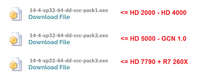

Reply 10 of 11, by agent_x007
Alternative WinXP drivers (bottom of the page) : LINK
45.37 KiB
992 views
Source for above info : LINK
They should fix "no install" issue for some cards.
