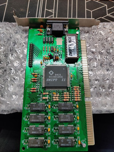

I recently aquired this video card, is not working and I'm trying to figure out where it comes from:
The attachment IMG_20230512_135448.jpg is no longer available

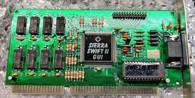

under the sticker it gets even more curious:
The attachment IMG_20230512_135728.jpg is no longer available
Any idea of where it comes from?

Reply 5 of 9, by Ydee
Vendor Sierra Semiconductor (then PMC-Sierra, lastly Microsemi): seems like Sierra Swift II 1MB ISA, unfortunately no more info about this.
Reply 6 of 9, by Grzyb
Sierra is well known for their RAMDACs.
I thought they only had one graphics chip - SC15064 a.k.a. Falcon/64, found on some PCI cards.
But no, obviously they also had two chips for ISA - https://www.electronicproducts.com/graphics-a … -24-bit-ramdac/

Reply 7 of 9, by emuboy
oh,but this is the sc15012, not sc15010, I wonder if is just a silicon revision or a different product, perhaps a prototype?
Reply 8 of 9, by Grzyb
emuboy wrote on 2023-05-15, 10:28:
The difference is clearly stated in the linked article:
"Two versions of the chip work with dynamic RAM (SC15010) or video RAM (SC15012) frame buffers"
Well, not fully clearly...
Your card is SC15012, but the memory chips are 44C256, ie. DRAM.
I guess SC15010 only supports DRAM, and SC15012 supports both DRAM and dual-ported VRAM.

Reply 9 of 9, by Anonymous Coward
The build quality of the card looks awful, but at least it appears to have an integrated RAMDAC.
