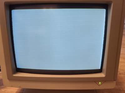

Another try......this time on old 14 inch crt monitor.
Started tomb raider demo under dos and this is the screen I got 😀

Ok, there is no need to try sound card as when it runs with voodoo in it freezes the computer 😒

Reply 22 of 32, by Rwolf
The board seem to have had some rough time, so it might be good to check for broken lines where you have scrape marks.
Checking for loose pins on the larger chips are also a thing, sometimes one cannot see an open solder pad connection easily.
(I sometimes listen for loose pins/pad solder by softly scraping along the pins with a toothpick)
Reply 23 of 32, by Imperious
Mine froze as it had a bad Ram chip attached to the FBI. I could get it working by limiting the ram available to 1MB.
In autoexec.bat You can try disabling the TMU or FBI chip and limiting the memory to each to 0, 1, 2MB.
i would first try disabling the TMU as tomb raider will work with no texturing.
Try all combinations, that's how I figured out what was wrong with mine.

Rwolf wrote on 2023-05-24, 22:49:
It has couple of scratches but not bad ones so I checked them and they fine. Chip legs...... I think I did check them about three times 🤣 only two needed soldering.

Reply 26 of 32, by Imperious
download/file.php?id=157969&mode=view
I would try playing around with memory sizes first. It likely won't work with FBI disabled. I could get Tomb Raider working with 1MB available to the FBI.
You can definitely still get just a non textured Lara with TMU or it's memory disabled.
Of course the Ram may not be faulty.
