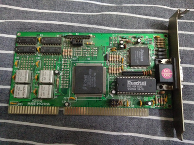

I have a Trident TVGA 9000c ISA video card and I use an AOC MW19N-AA 932Sw LCD monitor. My 9000c has 512kb memory, it support the resolution of 800x600 with 256 color mode. But my LCD refuse to accept the output from my video card. When set the resolution in windows, the LCD became black screen with error "Input not supported". I have another PCI video card, which is a S3Trio64V+. The LCD displays in 800x600 256 color mode with the card perfectly fine. So what would be the issue the 9000c has? Is it the refresh rate 9000c output that is non-standard? I have no way of finding the output refresh rate when the screen is black. However, when I set the resolution to 640x480 256 color, my LCD works in 60hz.
This is my current jumper settings:
1.78 MiB
1267 views
My current Jumper settings

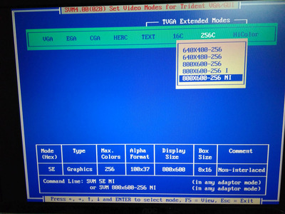

I cannot find the jumper settings specifically for my card anywhere, but here is a topic for 8900D which has a very similar jumper layout to mine. The jumpers settings in the manual says J7(open) is for non-interlaced monitors. I had my J7 open as well, see the picture I posted before.
Grzyb wrote on 2023-05-28, 13:31:
Try SVM.EXE - AFAIR there are options to test various refresh rates and interlace settings.
Input not supported when select 800x600-256 NI(the three 800x600-256 modes have the same result).
372.89 KiB
1161 views

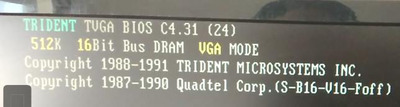

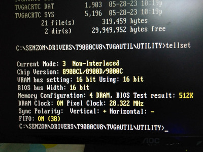

Also, are you sure that card has 512 KB of RAM? It looks weird... 4 x 41256 = 128 KB I don't know about those IBM chips, but the […]
It looks weird...
4 x 41256 = 128 KB
I don't know about those IBM chips, but they may be 41256 equivalents, so another 128 KB, and that would be 256 KB total - but that's not enough for 640x480x256...
The test result of the Tellset utility:
283.91 KiB
1161 views
The BIOS info screen when booting up:
15.34 KiB
1161 views

Reply 6 of 48, by Grzyb
OK, I'm inclined to believe those IBM 90x0711 chips are 256K x 3-bit.
Does 800x600 16-color work with your monitor?
And how about 1024x768 ?
Nie tylko, jak widzicie, w tym trudność, że nie zdołacie wejść na moją górę, lecz i w tym, że ja do was cały zejść nie mogę, gdyż schodząc, gubię po drodze to, co miałem donieść.

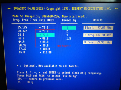

Reply 9 of 48, by GunKneeNeon
Grzyb wrote on 2023-05-28, 17:09:
Not sure how to select them... TVGACRTC.EXE may be the proper tool.

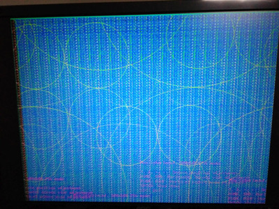

Ahh.... We've made a progress here. See my picture of the TVGACRTC utility. The frequencies from 75.0-98.0MHz are supported, which correspond the refresh rates from 58.41-76.32Hz respectively. All divided by 1.
599.47 KiB
1103 views
However, the images are not correct like this one.
607.61 KiB
1103 views

Reply 11 of 48, by GunKneeNeon
jmarsh wrote on 2023-05-28, 19:07:
How do you know those frequencies are supported for that board? They are rather high for an old ISA card.
Well, I'm not saying the board support that. I'm saying such refresh rates are supported by my LCD. Only rates in this scope output images to my monitor.

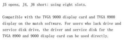

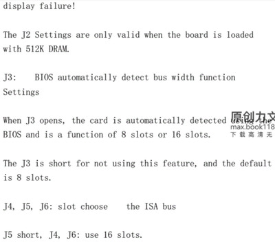

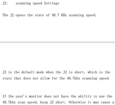

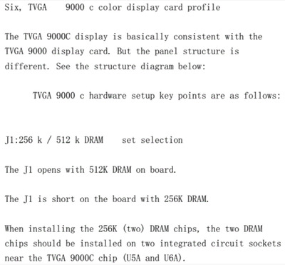

As for the jumper configuration, I never find a doc specifically for TVGA9000C. Well, not really, here is the doc about 9000C, but it seems not for this card. Because the card doesn't have jp3-jp5.
151.51 KiB
998 views
94.06 KiB
998 views
117.65 KiB
998 views
71.92 KiB
998 views
PS: Sorry to post so many screenshots, the site doesn't allow me to copy the text. The whole doc is here. The TVGA9000 part is more reasonably.
