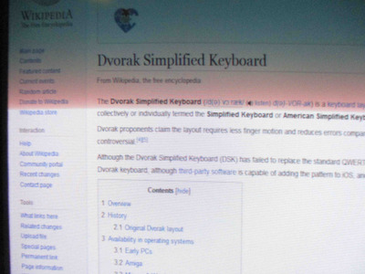

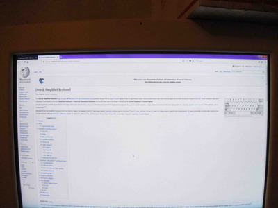

VGA has no inherent resolution limit, you can push as high freqs as your video card allows and monitor can accept. The main limit is video card, they usually have 400MHz pixel clock limit on VGA output which makes it impossible to do stuff like 4k for example.
2560 x 1600 @ 60Hz is not at all a problem, it is well below 400Mhz pixel clock limit and Hsync rate is near 100kHz which a normal high end monitor has no issue with.
I attached two images of 2560x1600 that I once experimented with on my 20" Nokia monitor. I didn't expec text to be as readable as it ended up being 🤣

Reply 9 of 11, by agent_x007
Tiido wrote on 2023-06-03, 13:43:
