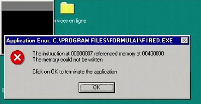

I've been working on RReady, a Rendition Verité wrapper for almost a year. I've almost got Formula 1 working and one of the fruits of my labour is a way, maybe, to get F1 running on a V2k series with standard RRedline 2.0 drivers. It should hopefully run on a V1k as well using standard drivers (instead of the special F1 drivers).
I don't know if this'll work and if anyone's actually interested. The custom Redline and Verite dlls need to go in the Formula 1 folder and the stock Rendition dlls should be in windows\system.
It looks like the only difference between the v1.0 and 2.0 drivers is the way parameters are passed. Some RRedline 2.0 Verite functions are implemented as passthrough functions calling the relevant functions in windows\system\Verite.dll. Both custom DLLs implement the required RRedline 1.0 functions (ending with _ in the function name). This isn't a full implementation of RRedline 1.0. The only game which uses it is F1 and it only needs a subset, which is fully implemented..

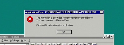

Reply 1 of 315, by chuky
I tried with a Diamond Stealth ii s220 (Rendition Vérité V2100) in Windows 95b on a Pentium 2 350 Mhz. I didn't install the driver from the cd because it looks like it is for the V1000.
The game opens a small window and I get an error message, saying "The instruction at 00000007 referenced memory at 00400000 The memory could not be written".
Then the crash report says things, I took a screenshot. It says F1RED caused a page failure in the module <unknown> at 0000:00000007
Registres -> Registers
Octets à -> Bytes at
Etat de la pile -> State of the stack
Then there's a crash report for kernel32 but I didn't take a screenshot.
Without your wrapper, if I try running F1red.exe (without the V1000 drivers included) it just tries to create the small games window but it closes immediately without any message.

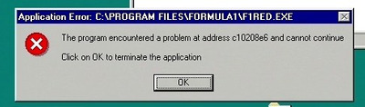

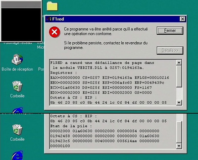

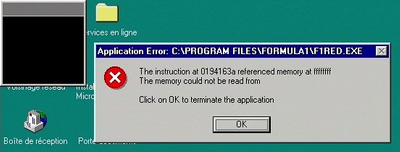

Reply 3 of 315, by chuky
Now it opens the small window and waits 1 second before crashing. I forgot to put the cd and it didn't ask for it, so it still crashes before checking for the cd.
Here's the error : "The instruction at 0194163a referenced memory at ffffffff The memory could not be read from"
Then there are crash reports.
Reply 4 of 315, by sharangad
chuky wrote on 2023-10-14, 20:20:
That's a bit better. Found another bug:
https://1drv.ms/u/s!As-dKk-N73dSlilBAAKx5l37XzkS?e=1xTkCx
MD5: d446780a430b7bb2bad553282ab59555
Source:
https://1drv.ms/u/s!As-dKk-N73dSlilBAAKx5l37XzkS?e=ndd1aT
MD5: f42f1262eed7764fa7b3a6e1226cf793

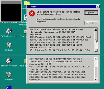

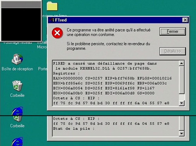

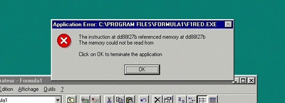

Reply 5 of 315, by chuky
With the previous versions the error was always the same, but with this one the error is different every time. It seems to look at different places in memory. Sometimes it's ffffffff, sometimes it's the same address it comes from, sometimes it's somewhere else. All errors happen before it checks for the cd.
I made a zip with screenshots and the crash report. They're in the chronological order where I got them, but some of them are not from the same session.
<inconnu> means <unknown>
I'm not a programmer but it looks like the address is random and the error happens before the address itself. If you want, maybe you could tell me how to use something like windbg. I don't have it installed, but it could be the occasion for me to learn something. edit: or maybe I should start compiling myself and look at instructions 1 by 1 as they run ?
Reply 6 of 315, by sharangad
chuky wrote on 2023-10-15, 15:11:
With the previous versions the error was always the same, but with this one the error is different every time. It seems to look […]
If you've got a copy of visual studio 6.0 you might be able to, unless the app checks for a debugger. Let me add some logging to it, so we can see where it fails. That will take me some time but I can probably get it done before tomorrow evening for you to test.
You can probably enable crash dump logging for the app. Not sure how you do it in win98.
Dr. Watson logs will probably help, but that's a text log, not a crash dump.
I think it's best to wait for logging.

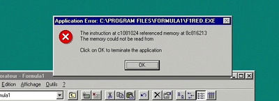

Reply 8 of 315, by chuky
I don't get a Windows crash error. The log is created but I get a message saying "Logging function missing in V2k. Rready's Redline..DLL" (with "..DLL" instead of ".DLL") the title of the message bos is "C:\WINDOWS\SYSTEM\Verite.dll"
The log file V2k.RReady.LogFile.txt says:
Loaded system\redline.DLL library
VL_OpenVerite_
It'll take a bit of time for me to install what's needed to help debugging. I'm still in Windows 95b, maybe the dlls are too old for the function you wanted to use.
edit: It's the same if I make a copy of redline.dll and call it redline..dll.
