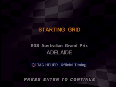

Reply 82 of 315, by chuky
Version 002 and 003 hang at the same place. Version 002 is behaves the same, but version 003 has wrong text textures in the pre-race screen but not in the credits. In the pre-race screen, the top half of the text is fine, but the bottom half is the alphabet texture, or the texture of digit numbers. In the credits, text and the Bizzare Creation textures are fine with version 003 (I didn't wait for the Psygnosis texture to appear). Maybe it's pre-made images and not actual text in the credits.

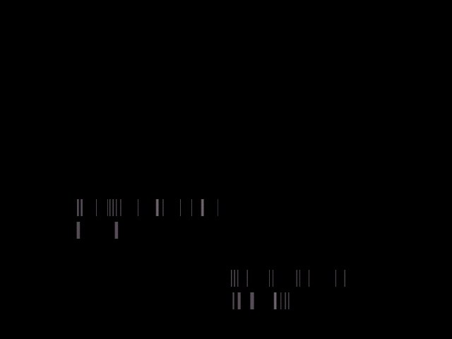

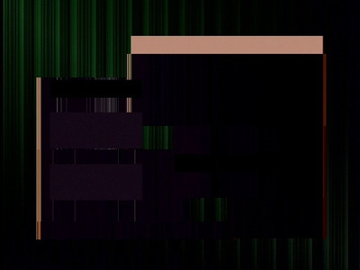

Reply 84 of 315, by chuky
This time the pre-race screen looks fine (it wasn't in 11-16-003), but the menu and the credits don't display right. I took screenshots. The game still hangs after the pre-race screen. Screenshots have the same resolution, I don't know why vogons shows one bigger.
I put 3 logs, 1 with the game hanging after the pre-race, 1 going to the credits and back to the menu and quitting, and 1 just starting the game and quitting from the menu.
Reply 85 of 315, by sharangad
I think there's a version number mismatch copying the files across:
Check the timestamps and possibly the MD5s.
This should still lockup, but menus and everything else should render correctly:

Reply 86 of 315, by chuky
With this version the menus, the credits and the pre-race screen look fine. The game still hangs after the pre-race screen.
