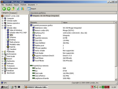

for zyga64: Not quite expert of PCI info strings, but i hopefully this can be somehow helpful as i took the screenshot from Everest on Windows 2000, where apparently same drivers on same PC (of course took from 2K_XP inf folder) works just perfectly -_-

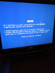

Sadly not on the core system where im struggling to get same results as 2000, that is 98 SE. If i try to select to update VGA Standard drivers from device manager to the driver folders, it just says that the better driver (vga standard inf driver inside windows folder) has been already installed, doing nothing.
If i try to select the disk driver and manually point to the Win98 folder with the Inf files, i get to a list of compatible SiS chipsets name which are all pretty confusing. Then again, if i choose SiS 741 or SiS Mirage Graphic (almost the same name of the Win2000 working one), that's what i get after each reboot:

Reply 4 of 13, by zyga64
Based on your screenshot - line for your card should look like:
%Vender.ASUS.DeviceDesc6%     = Driver4.Install, PCI\VEN_1039&DEV_6330&SUBSYS_815c1043
If you add it somewhere in the [mfg] section of the sisgr.inf file, Windows should match the card to the driver.
...But still I'm skeptical because you said that forcing driver (for the same card as for Windows 2000) caused a blue screen 🙁.
In any case, why not give it a try?
