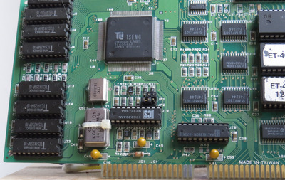

I have a defective ET4000AX ISA graphics card. The card came without DRAM, RamDAC and the Clockgenerator Chip. I plugged everything in and the card remains dead in an ISA 486 mainboard. All additional components attached have been tested and work.
The card has no label and no FCC ID. Does anyone know the jumper assignment JP1 1-2 / JP2 2-3 / JP3 1-2 settings?
74F244 are installed as address driver chips and two 74LS245 for the data signals. On suspicion I'll remake the two 74LS245...!?!
Any ideas where I should look for the error?
The attachment ET4000AX_defekt.jpg is no longer available

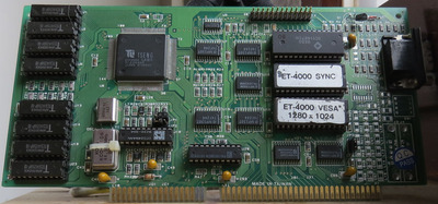

Reply 1 of 20, by Thermalwrong
Could you get a front lit picture in higher resolution?
Also, where's the RAM?

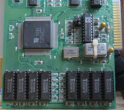

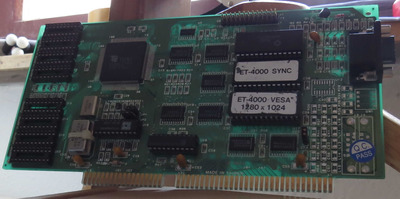

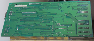

Reply 2 of 20, by Frank
There are two scratches, but I checked and the connections are ok. The DRAM chips are fast enough. I also have it on another ET4000. 70ns chips make no difference.
The attachment front.jpg is no longer available
The attachment back.jpg is no longer available
The attachment et4000ax_1.jpg is no longer available
The attachment et4000ax_2.jpg is no longer available
Reply 3 of 20, by MikeSG
There may also be another problem but I don't think the RAM chips are fast enough.
The ET4000 manual says "the SCLK's [System Clock] cycle time should be equal to the CAS low pulse width and less than 25ns." - Page 24, http://dosdays.co.uk/media/tsenglabs/Tseng_La … roller_1990.pdf
The 44.9MHz crystal gives 22.2ns(?), so the RAM CAS needs to be less than that?
"tc514256p-100" have a CAS access time of 30ns. https://html.alldatasheet.com/html-pdf/146037 … /TC514256P.html
Also, one of those jumpers (JP1?) is IRQ I think and will not make the card work if switched wrong.
Reinserting the chips will help connection as well (RAMDAC, BIOS, etc)

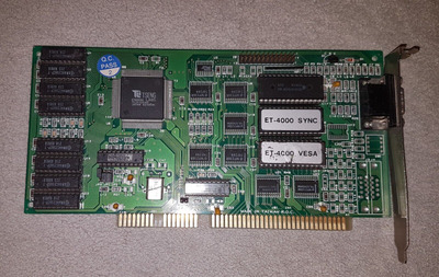

Reply 7 of 20, by Thermalwrong
Thanks for sharing the additional pictures, that helps a lot 😀
You say it remains dead, does that mean no VGA output or the BIOS gives the "no VGA" beep code error?
It seems to be very tough to find any information on your particular card, the closest I've been able to find is this one:
The attachment ebay334786539738.jpg is no longer available
Not the same card revision but clearly the same PCB layout. Looks like there are some differences between the TC6100AF and TC6058AF chips so your card having both a PLL and a regular crystal should be fine as-is.

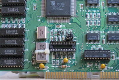

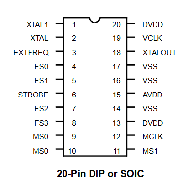

#1 - please verify the ICS PLL chip - Is that definitely installed the right way around? More significantly, is it even the right chip?
ICS2494 pinout, should cover the ICS2494N as well:
The attachment Screenshot 2023-11-22 at 16-18-55 The DatasheetArchive - Datasheet Search Engine - ics2494_ics.pdf.png is no longer available

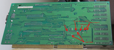

Looking at the traces to the crystal on the back of your card, I'm not sure the ICS2494 is even the right clock generator - see the traces to the XTAL are in the middle of the pins on your card but are on the edge of the ICS2494 pinout shown in the datasheet. Unless the ICS2494N has a different pinout that's not documented anywhere, this may well be the main problem on your card.

Can you pull the clock generator and verify which pins on the socket connect to the 5V rail?
It may even be an ICS1494 looking at the big data book - check out the application circuits to see which one matches your board layout (PDF page 20): http://www.bitsavers.org/pdf/integratedCircui … s_Data_Book.pdf
Or maybe even a CH9204...
#2 - Check the BIOS / VESA chip, it should be a 27c256 EPROM and you can compare with other BIOS files here, where there are a few to compare with: Tseng 4000AX Weird Characters
(I'm not totally sure those will work since there may be differences between TC6100AF vs TC6058AF BIOS files, idk)
The one labelled "SYNC" is the translation ROM as far as I can tell and it's not essential for the card to run.
#3 - resolder the QFP pins 😀
#4 - The transistor at Q1 looks kinda twisted, make sure that's not shorting
Reply 8 of 20, by Frank
Thermalwrong wrote on 2023-11-22, 16:44:
... no Output the Monitor is black, no Sync. No beep

I´m not sure the ICS2494 is the right chip? See my picture ...
The attachment back_ICS.jpg is no longer available

Reply 9 of 20, by Thermalwrong
That's good, that means the VGA BIOS section is probably working and you don't need to worry about the LS244 / LS245 chips that connect up the ROMs 😀
Ah, I thought that might be the VCC trace. That means we can rule out the ICS1394 / ICS 1494 then.
I wonder what clock generator could have the VCC at pin 10??
Can you pull the clock generator and look inside the socket to see if there are any markings?

Reply 11 of 20, by Frank
Pin1 is marked on the soldering side of the PCB with a square via.
Pin1 = GND
Pin2
Pin3 = over 10R (R38) to VCC
Pin4
Pin5 = Quartz 14,xxx Mhz
Pin6 = Quartz 14,xxx Mhz
Pin7 = Quartz oscillator 44,xxx Mhz
Pin8 = GND
Pin9
Pin10 = VCC
Pin11
Pin12
Pin13
Pin14
Pin15
Pin16
Pin17 = GND
Pin18
Pin19
Pin20
VCC = +5 Volt

Reply 15 of 20, by Frank
The card now works with the ICS1394...

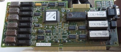

Reply 19 of 20, by Thermalwrong
Congratulations on getting the card running again 😀
The RAMDAC issue you're describing with Win95 sounds like when I try to run 16-bit modes on an 8-bit DAC that doesn't have any such mode. But surely 256 colours should still work, maybe the DAC to use depends on the BIOS setup?
See the picture I posted above of the similar card and that uses a regular 8-bit RAMDAC the KDA0476CN-80. Perhaps try a basic DAC to see if it likes working with that.
