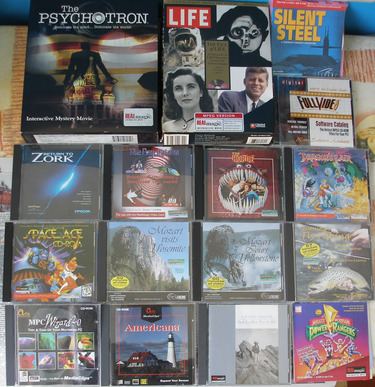

I. The games that certainly exist.
Ia. DOS games
1. Dragon's Lair.
2. Space Ace.
3. Return to Zork.
4. The Horde.
5. Entity.
6. Flash Traffic.
7. Crime Patrol.
8. Drug Wars (Crime Patrol 2).
9. Lord of the Rings.
10. Man Enough.
11. Space Pirates.
12. Conspiracy.
Ib. Windows games
13. Prince Interactive.
14. The Psychotron.
15. Silent Steel.
All games are available on the web, except 10, 11 and 12 (but their owners have promised to share the images).

Well, and there are 37 more titles that are not actually games! There are three interactive movies for kids, a couple of encyclopedias, but the rest are multimedia titles - collections of movie clips, professional education videos etc. I have actually bought several of them - and yes, just like 'Silent Steel' they are NOT ReelMagic exclusives and could be run on any PC with software MPEG decoder. So I won't even list them here 😀
Nice detective work and compilation!
BTW, Silent Steel also has an MPEG2 version released in DVD-ROM.
I was going to say that also - and given the DVD version, the MPEG version is much less interesting to me.
What is the Lord of the Rings game?
I don't know that I was aware of Man Enough having a reelmagic version - do you have any scans of the box or CD?
Reply 61 of 165, by Uka
j^aws wrote on 2021-05-08, 19:45:
Thanks 😀
Hammer wrote on 2021-05-09, 05:16:
No 😀 I have played the DVD version, and what do you know - the MPEG version is actually better!
In DVD, they have somehow messed with the scenes, so it is abridged and incomplete comparing to the CD versions (both MPEG and non-MPEG).
It is a 1994 MPEG REALmagic version of 'The Lord of the Rings Enhanced CD-ROM' from 1993, which is in turn an enhanced version of "J.R.R. Tolkien's The Lord of the Rings, Vol. I" RPG.
Yes, there are some scans! I will send you a PM.

Here is my small collection so far 😀
