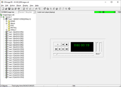

Sega Rally 1997 (pretty good tracks)
I always liked CDMage for its builtin player...
